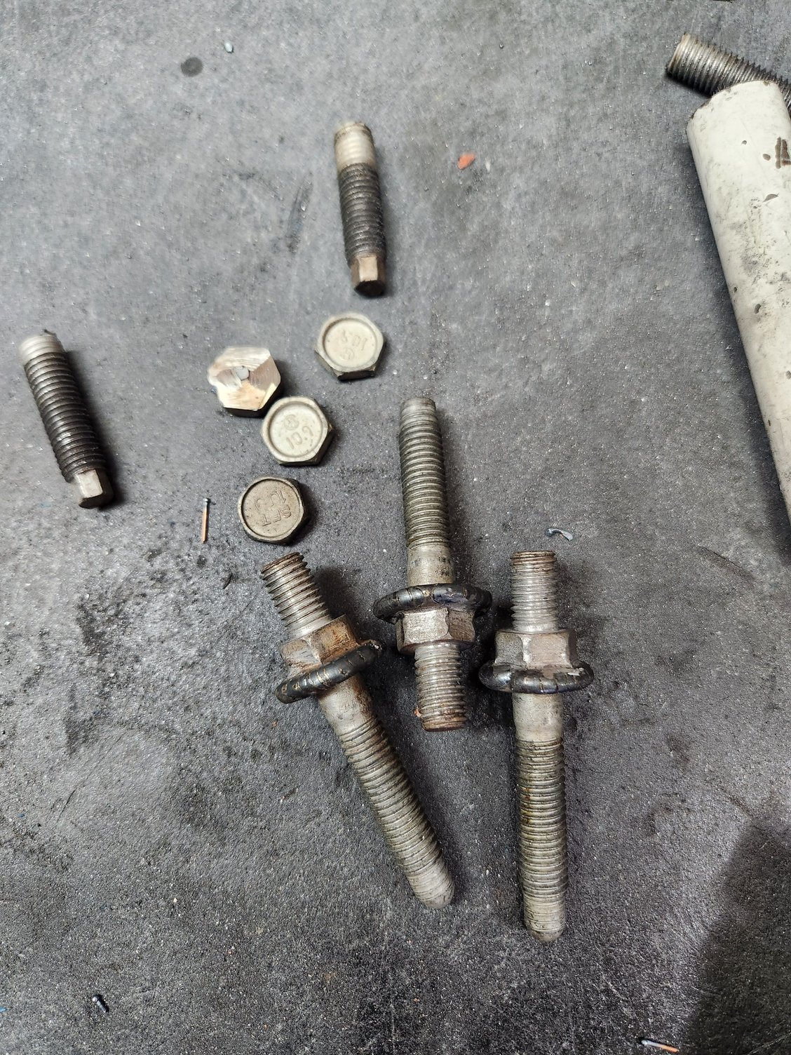

Does anyone know if the 2003 Z06 was prone to counterfeit or substandard fasteners on the vehicle? My 2004 Z06 was perfect and I raced it for years doing all kinds of service including engine rebuilds. I'm now racing a 2003 Z06 and this thing is a POS! For example, I have sheared off 10.9 bolts on the rear caliper on re-install. I have twisted off the exhaust bolts with nuts frozen onto the studs! Even with heat and break free I have deformed the remaining 5 studs but got the bolts off. Metal material is avulsed from the studs all 5 remaining and they cannot be reused. This reminds me of working on hondas for the 90's where any fastener removed I would just throw away and put new not honda hardware.
Anyone else have this problem or perhaps I got a monday car and everyone was hung over?

Lots of people have the same problem with the exhaust bolts

I have a 03 Z06 and have not had issues. Chances are the bolts you’ve had issues with had been over torqued by past mechanics or owner. I doubt it’s a material issue since it’s more than one size fastener.
Of course the exhaust bolts have been heat cycled so many times it’s no surprise on those.

Over torquing is probably the culprit. I bought plenty of GM hardware and haven’t had problems. If you’re talking grade 10.9, they have great tensile strength but are brittle.
You might try easing them out, pulling them both direction until they start to move a little. Also, if you have been using impact wrenches, try using a hand ratchet instead to loosen the bolts.

20yr old car, lots of one use torque to yield hardware= broken hardware

I think GM says to replace those rear caliper bolts. I never have and change pads every track day, but I always use torque wrench.
Exhaust bolts on a car that old should almost be expected to break! I use brass nuts on all exhaust systems.
I take it you purchased the car used. Big problem is you don't know who worked on it or how they abused it during repairs (over torquing, cross threading, ...).

Yeah... I'm just a little shocked by how poor my 03 car is when my 04 was like the brick shat house by comparison. I have taken to throwing out hardware on this car and replacing with new like I did in the old days with Hondas. I did not want to wait for exhaust hardware so I cut off the bad parts and welded good parts to make new exhaust studs so I could get running. Wasted 2 hrs!

I've been working on an '03 and it hasn't had problems like this. Same with an '01 and '00. Only guesses are the car was exposed to salt and/or over torqued.
20 year old car and ugga dugga is a meme for a reason. Some people never use a torque wrench, tighten to when they can't turn it and often with air tools.

The manifold studs are shitty and then with the heat they eventually rusted making them even worse. I think 4/6 of mine broke and the other 2 were damaged when I took my exhaust off. There are many cases of them breaking off or being damaged.
The other bolts were likely damaged by previous work before you got the car and you finished them off.
