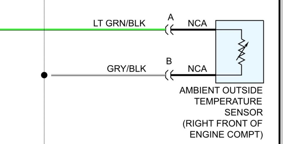

Apparently, my air temp sensor is missing. There are two electrical wires with connectors hanging loose. One is for the horn (currently disconnected) and the other is for the air temp sensor (which is missing).
How do I identify which set of wires goes to the horn and to the air temp sensor?

Wiring below…horn wiring is a DARK green/black !!
Is there any system you don't have a schematic for?

Thank you so much!
