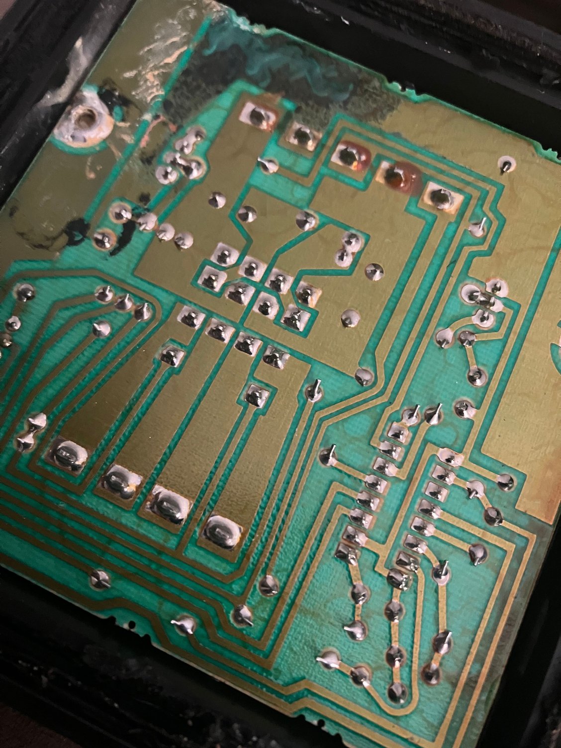

I decided to do some tests and everything passed with the 5- pin connector.
I could not get +/- 12V on the (A-B/C-D) 4- post terminals of the HCM with the 5-pin connected.
I decided to take off the HCM and have a look. See attached.
theres a corner that was open on the back of the HCM, and moisture has gotten in there over time.
I decided to order a new one anyway given the current state.

UPDATE:
I have replace the HCM, and upgraded the gears in both motors.
the issue has not returned.
The HCM was purchased from Zip Corvette.
item # HDL-276
upgraded gears were from Amazon - unbranded, but had multiple good reviews.
I’m assuming it was the HCM that was the issue given the items and pictures listed above.
