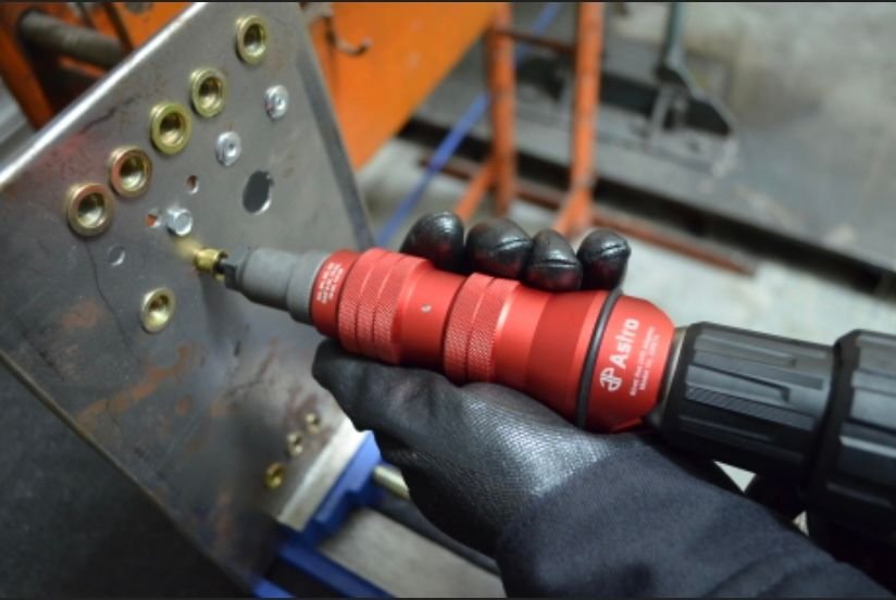

I’m not sure what you have for space but Riv nuts are strong and reliable
