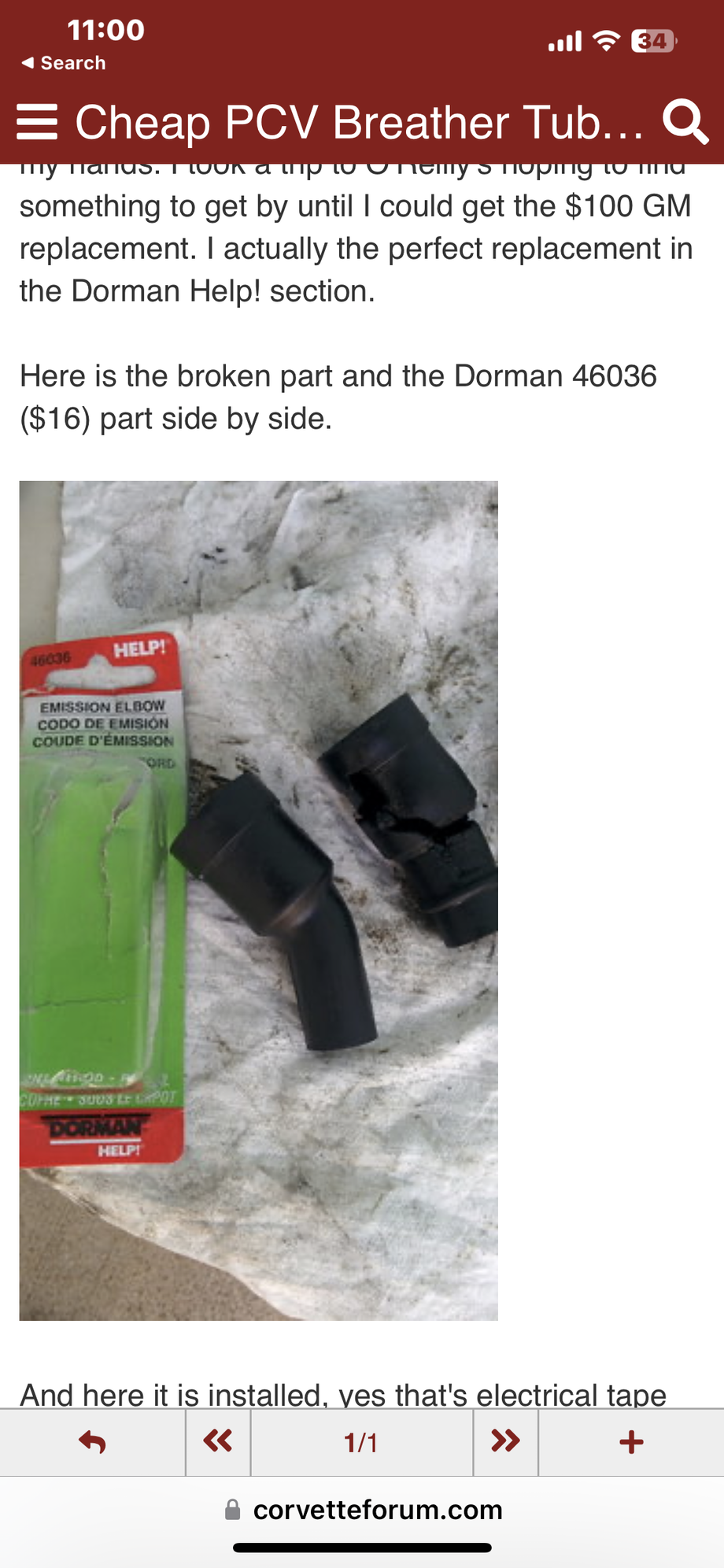

Thanks, Lenny 72. Unfortunately, that boot is not available as a separate unit. You have to buy the whole assembly to get the exact factory boot that encases the PCV valve.
However, someone posted that they found this item at O’Reilly’s auto parts, he even listed the number I went down to O’Reilly‘s yesterday and got the part that he listed and it fits great.
This boot will take the place of the PCV valve boot on the LS1 engines, in case yours comes apart or disintegrates, etc.. I picked the same one up at O’Reillys yesterday and it works great.
