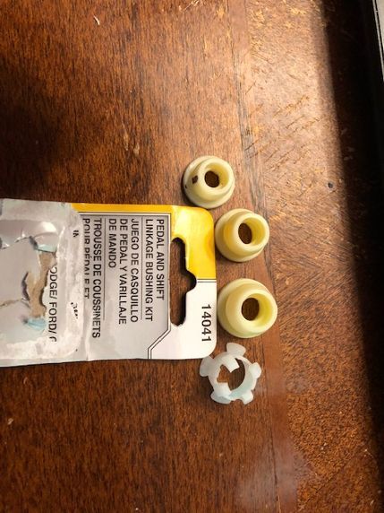

Any auto parts store. I used these on my C6 so I image there isn't a difference. The one with the black mark is the one you need but they only sell it like this.
