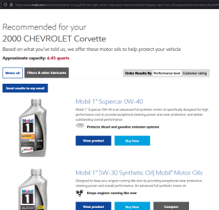

Based on a 2000 service manual GM specification 4718M was recommended for North America.
Mobil 1 has the FS 5w-40 on their site and that spec is not mentioned.
The same service manual says API SJ is acceptable for vehicles other than North America and the Mobil 1 page does list API SJ as one of the specs that oil meets.
If you really want to get into the weeds, figure out what superseded GM 4718M and what superseded that until you get to something current.
If you want to keep it simple, go to Mobil 1's website and use their tool. FS 5w-40 doesn't come up for a C5.

Why do you think Mobil 1 doesn't recommend it?
Probably because GM spec'd 5w30 for these engines and their online tool is basing it's recommendation off of that
Old Dec 1, 2023 | 12:56 PM
Dads2kconvertible's Avatar
Dads2kconvertible
Joined: Sep 2021
Posts: 2,555
Likes: 1,213
They do recommend a different 0w40 but not the 5w40 in question.
Seems like if that oil were recommended for the C5 it would be on the list. And maybe they do for a different year or model, I didn't check them all.
