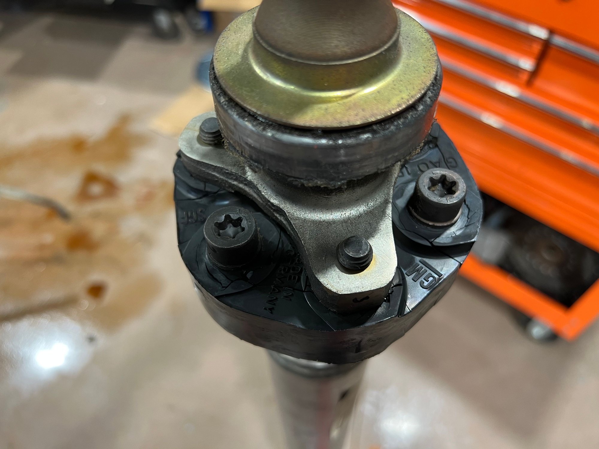

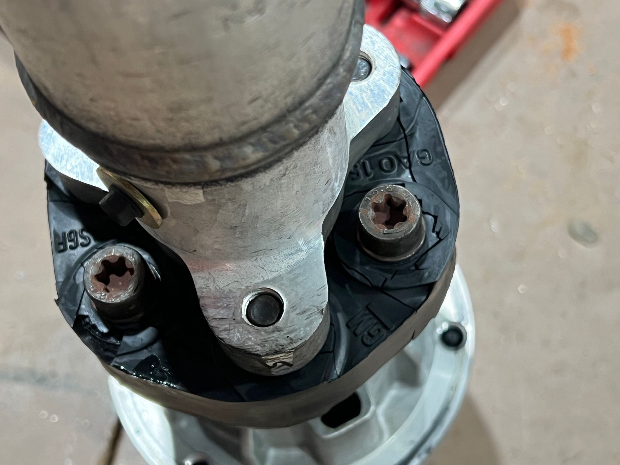

The first gear popping out could be from the shifter or linkage adjustment.
96,000 originals
The Grinding
Well it could be the same as above. The more likely cause is the previous owner was using his “ racing clutch”. and your synchros are toast.
Lastly on the torque tube. Hopefully when the clutch was done the tube had a refresh with new bearings and couplers. If not then you’ll be doing that. If they are the originals then your on borrowed time IMO.
