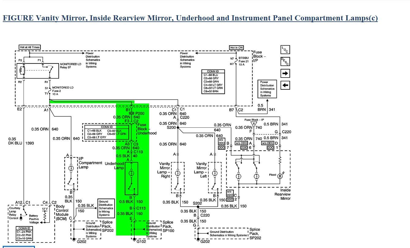

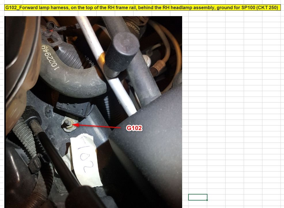

oelarse's Avatar
oelarse
Joined: Jul 2011
Posts: 996
Likes: 306
From: Southern Norway , Europe
Try to measure voltage between ground and fuse 2 on diagram (R1 term on relay) and between ground and P1 on relay)
These voltages shall be equal , but burned contacts in relay 37 can cause voltage drops over relay contacts.
Also check ground G102 and SplicePack 100 for good continuity .
