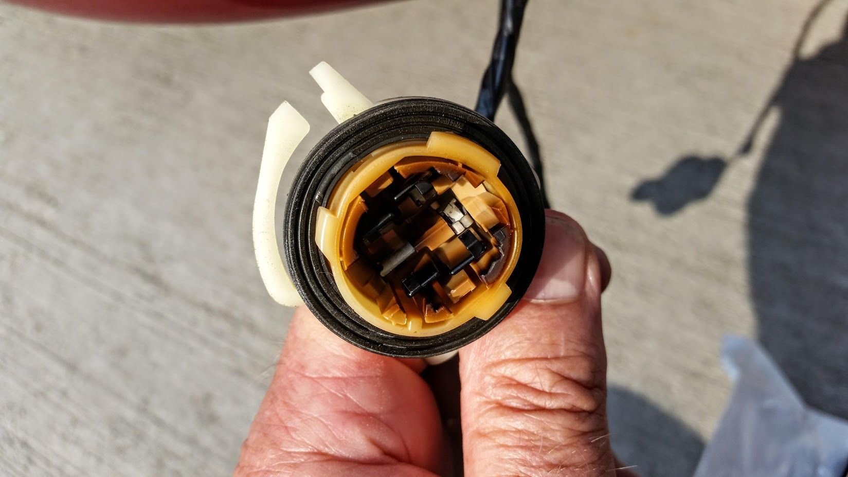

This is what happens to your regular bulb sockets. This 2004 had only 15,000 miles. You need to change to LED switchbacks if you want reliability.

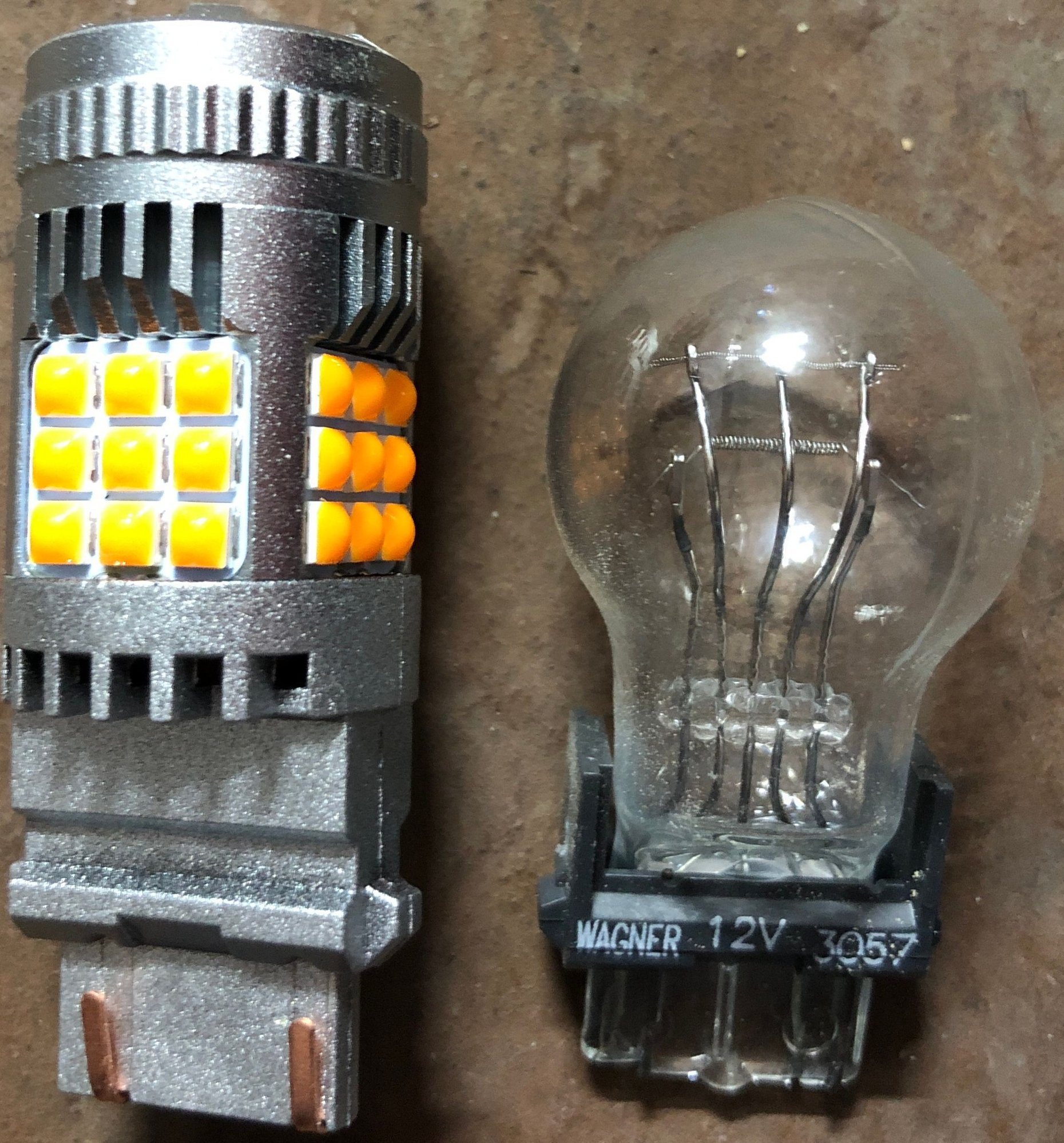

You can just put
these LED bulbs these LED bulbs
in if the sockets are still good.

These These
claim they work without a hyperflash harness. I ordered a set today, will report back with results. Doesn't seem like a 12,000 rpm fan is likely to last the life of an LED bulb. And where is the heat supposed to go when the bulb is in an enclosed housing?

These claim they work without a hyperflash harness. I ordered a set today, will report back with results. Doesn't seem like a 12,000 rpm fan is likely to last the life of an LED bulb. And where is the heat supposed to go when the bulb is in an enclosed housing?
Preliminary results indicate they work as advertised. I tried one in a tail light housing since that is easier to get to. They are about a half inch longer than the standard 3057.

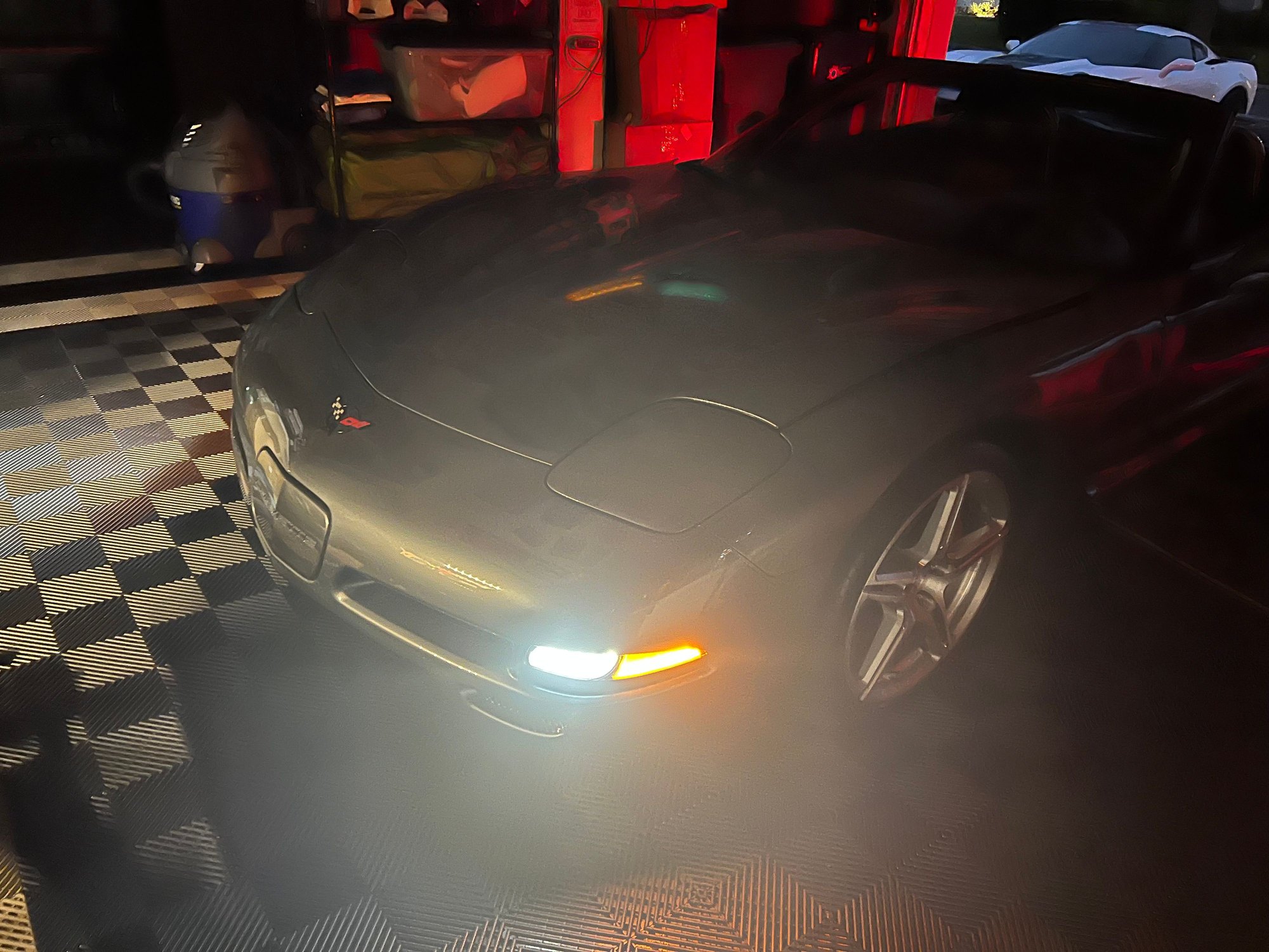

New clear lens housings were on the car when I bought it, the heat damaged OEM housing also came with the car. I installed the white to amber switch back with a hyperflash harness from Sharp Lighting Innovations;
https://sharplightinnovations.com/sh...97-04-corvette
First off I hated the yellow/amber DRLs as they seemed so dated looking. I think the white LED lights look so much better, more modern and also improve the other driver's visual recognition of the car. I think the Pewter color on the C5 makes the car seem somewhat invisible or much harder for other driver's to notice quickly in traffic. Not sure I would want to drive the C5 without any DRLs, especially with all the distracted drivers in their huge SUV's with their line of vision so much higher.
