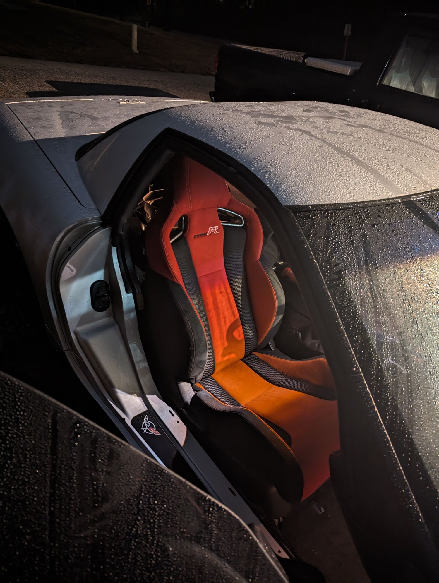

The C5-C6 seats leave a lot to be desired.
I was considering C7/C8 seats as an upgrade and adding the wiring wouldn't be the end of the world until I came upon a steal on the best seats in an OEM car
10th Gen Civic Type R OEM front seats
The seats physically fit in the C5, but like most need the C6 seat belts.

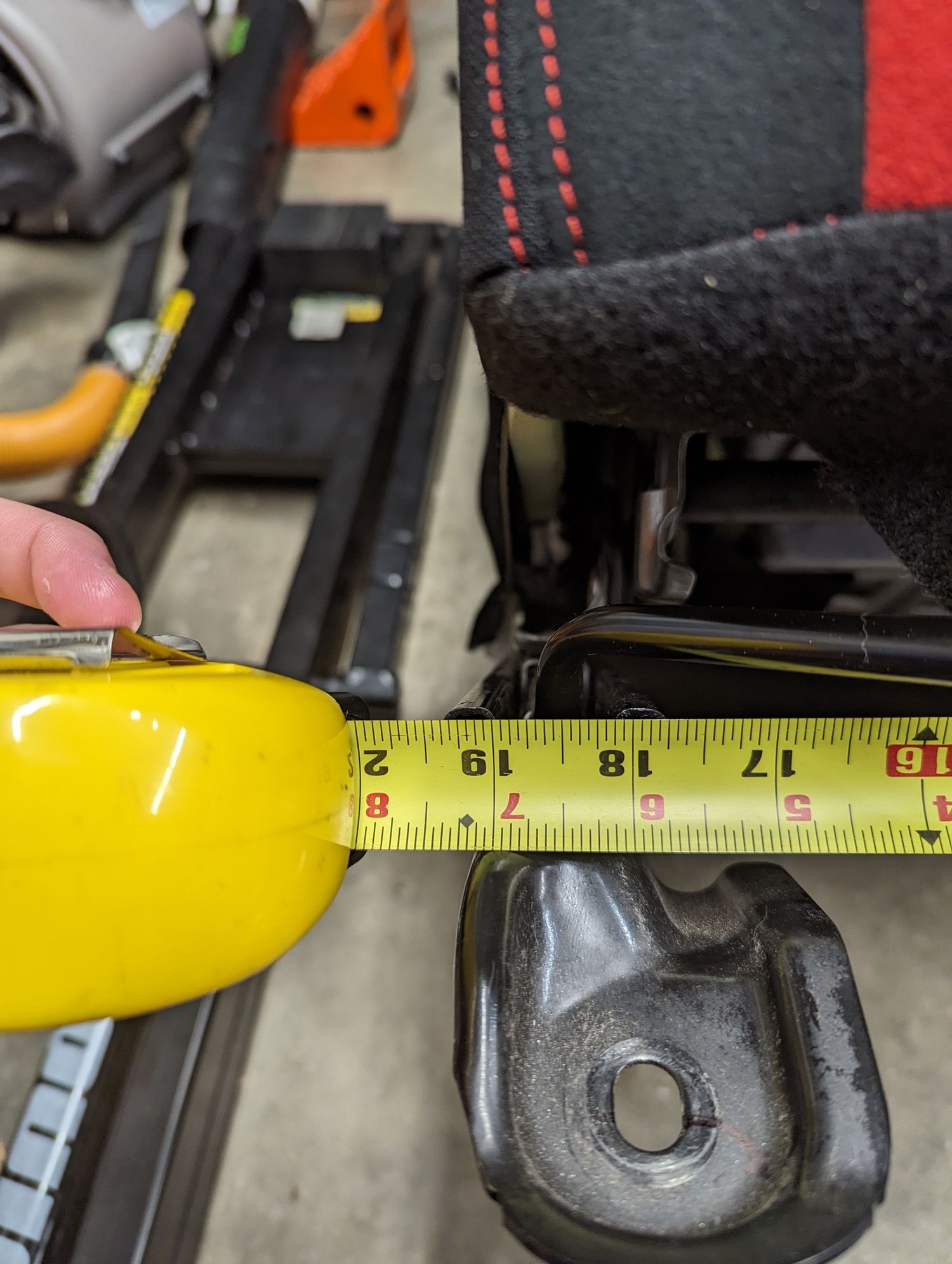

Issue is... The driver side sliders are integrated to the seat frame.
It would take drilling out the rivets and that's irreversible to a maybe..
MIGHT be possible to flip the sliders to be more narrow but still wouldn't fit
C6 seats for measurement; slider end to end width is 16\"
Sliders on CTR seats are 19\" roughly.
For a closer look
​​​​So the plan is to drill out the sider riser "feet" for lack of a better term. Have these sliders mounted to hopefully a low flat seat mount that's wide enough.

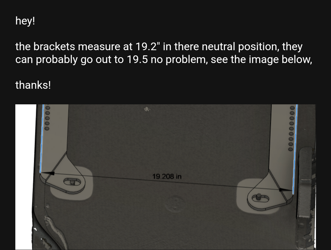

FDF seat brackets seem to give the most horizontal room however I have no measurements and no response back from them.

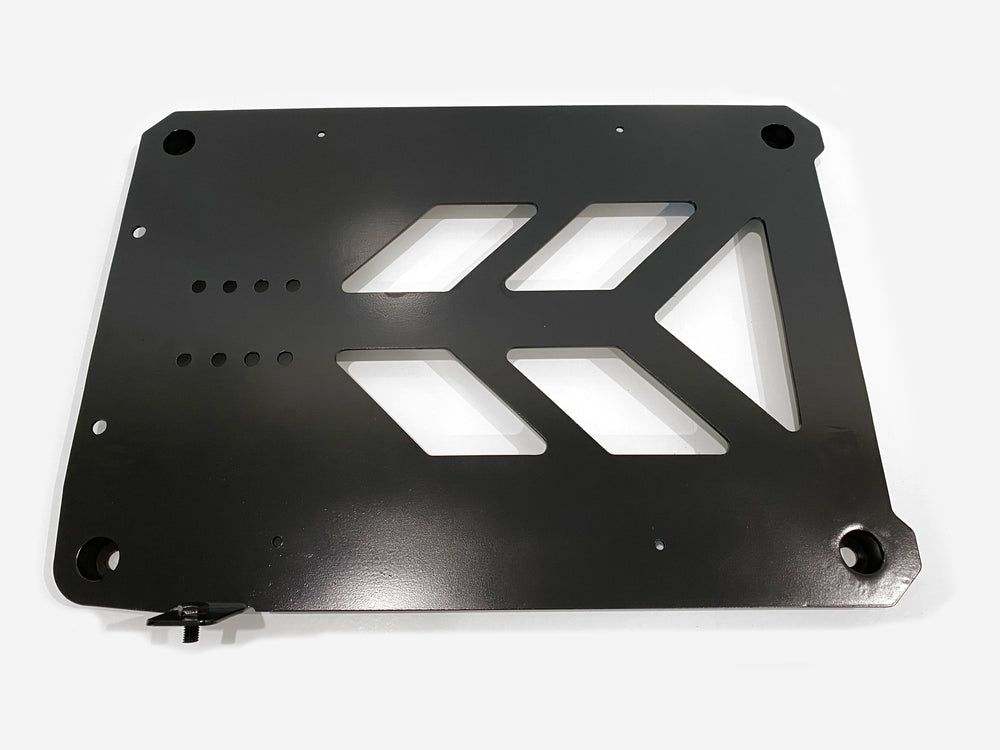

While costly it seems the only Off-The-Shelf option is
Pure Performance Rail Platforms
Shown is the side mount bracket vs slightly sloped bracket available. $650 per set seems high for what seems to be simple.
It seems I could have a plate cut in aluminum, add some spacer and the extended seat bolts others offer for an easy fit.
Just checking to see if anyone else knows options in case others may want to replicate this.

These CTR seats aren't ideal. Evo 9 Recaros would be an easier option. In my search I found the FDF seat mounts would likely be the closest off the shelf option but wasn't ideal.
The mounts in the wide configuration seem to be able to hit the width limit of the interior.
