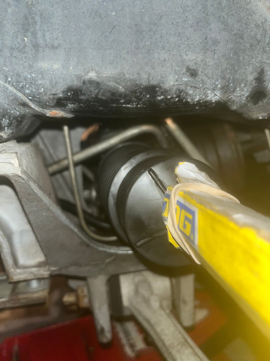

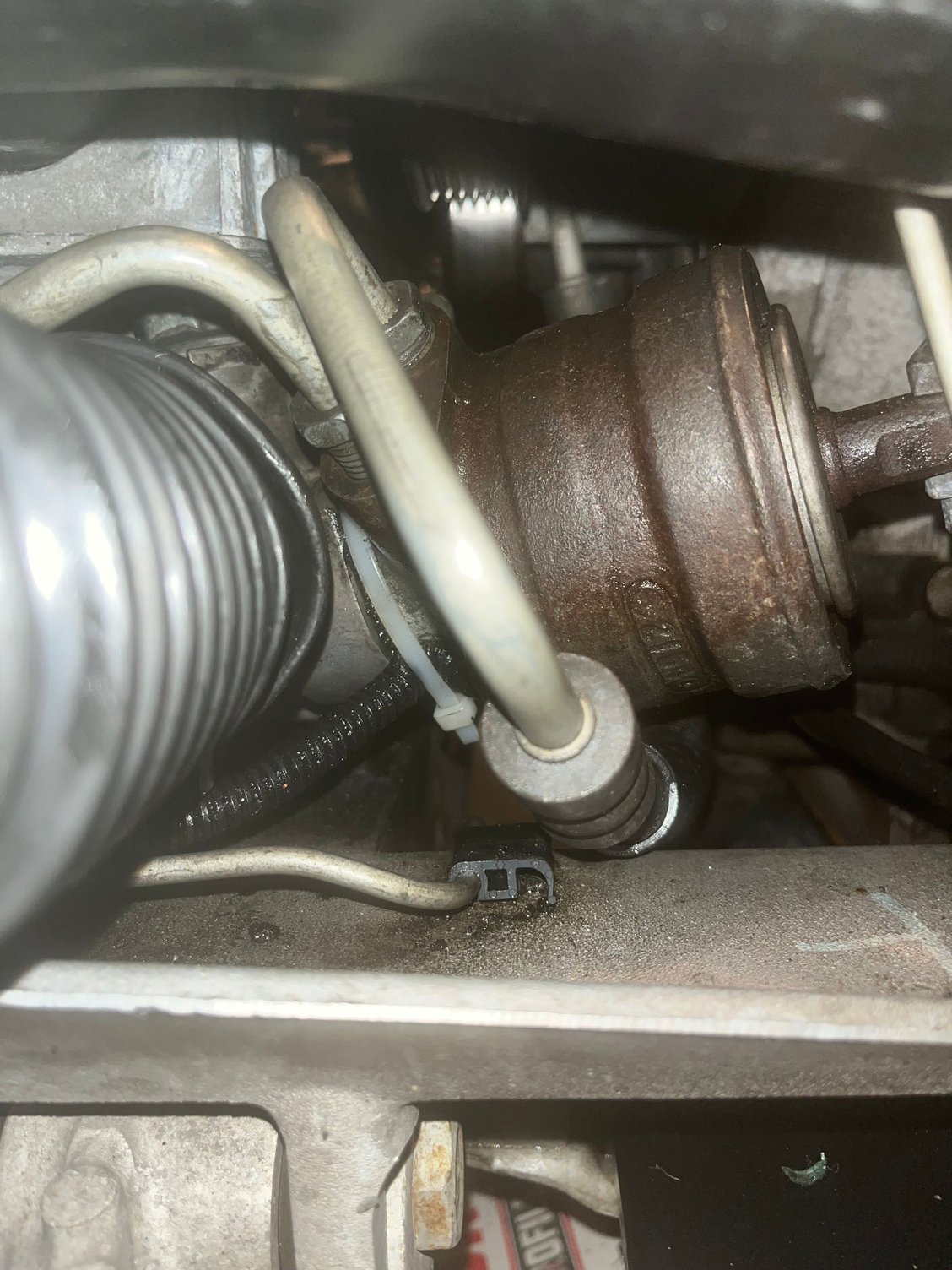

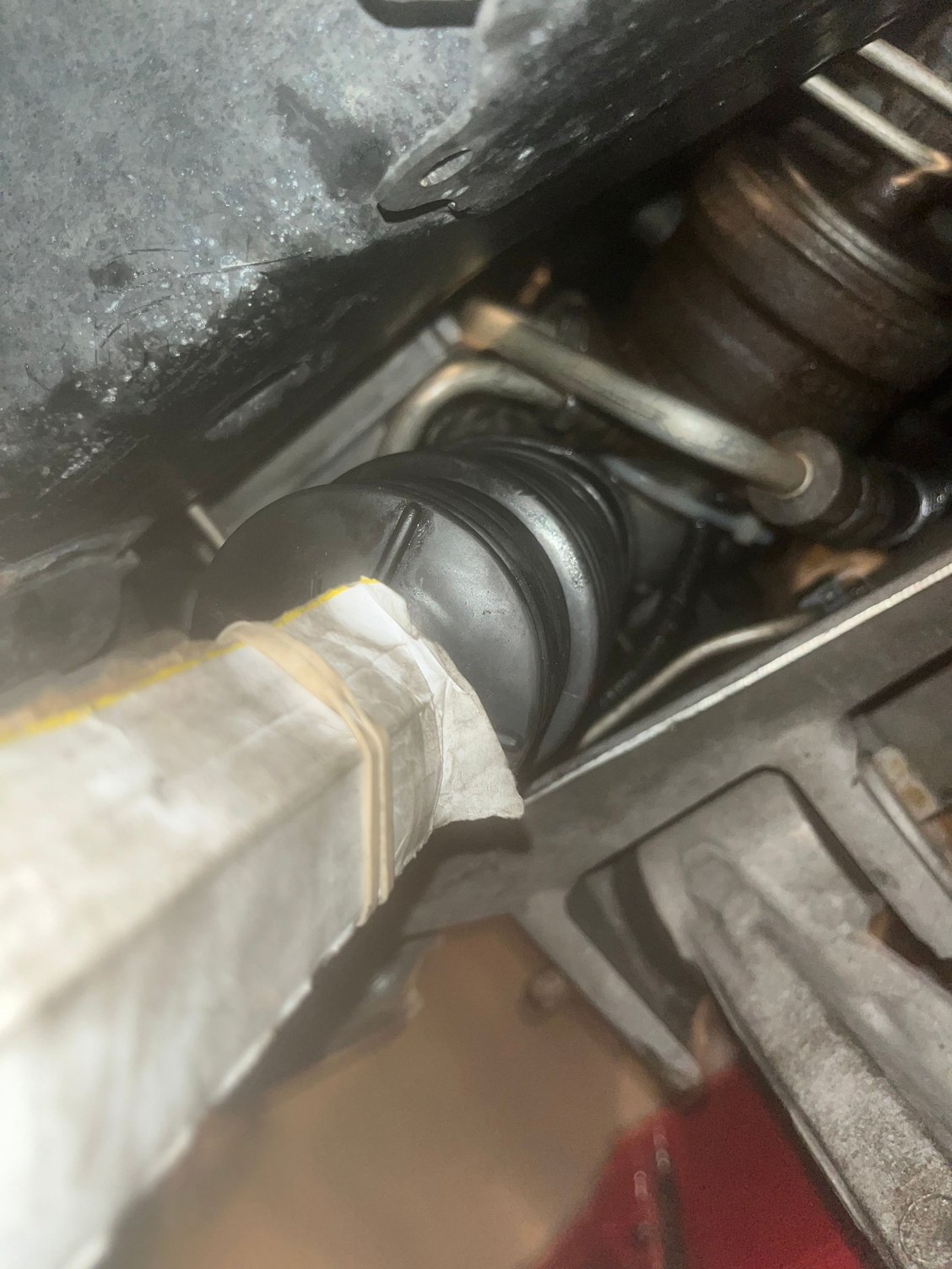

I just installed power steering rack in stock 2003 z06 vette. I replaced h/b, seal, new inner /outer tie rods and boots. I was able to get the top power line from the pump on. I cannot get the bottom power steering line on (from the p/s cooler.
I tried for 30 min. All by hand so nothing is stripped
Shall I remove top one and try bottom line first?
should I remove p/s line from p/s cooler and try reverse
is that bottom line hitting boot?
is the top line cramping bottom line?
does top line look good?
Do I have top /bottom correct ?
see pics

Ok so was able to complete.
what I learned .
1 put lower power steering line on first. Also unbolt the p/s cooler and let it hang. This take all the tension out of the line and makes it easier to go in.
2 then put upper p/s line from the pump on. This line goes under the steering column.
clean all threads and lube with grease. All lines have to go into my hand 100% of the time before you use any wrench.
18inch stubby wrench is amazing and bought on amazon

Glad you got it.
My only advice was going to be that getting the thread started is a bear because of line tension messing with you while trying to hold it perfectly lined up at the same time as using the other hand on the wrench.
