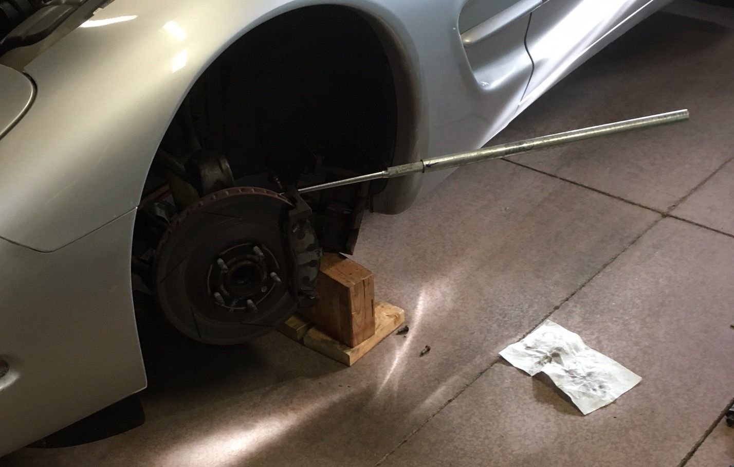

I always hang the caliper from a pre installed hook in the fender well. The calipers came off easily, only two bolts, blue thread locker, at 23 foot pounds. I hang the caliper with wire from the hook in the fender well and also set it on blocks. Note the wheel angle for better access. Start the engine to turn the wheels or you may overflow the PS reservoir. Ask me how I know.
The Caliper bracket bolts require a cheater. Or bigger muscles than mine. Factory installed caliper bracket bolts are installed at 125 foot pounds + with orange thread locker and absolutely require a cheater or use of a floor jack on the breaker bar. The FSM says to replace these bolts but I have found that blue thread locker works fine. These below were installed with blue thread locker five years and eleven track days ago, still very tight but came loose with the cheater:
1/2 inch drive breaker bar plus two feet-
Originally installed caliper bracket bolts on the rear will require the car to be raised quite high for cheater or floor jack use because the rear wheels cannot be turned at an angle for better access like the fronts.

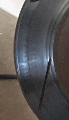

The old rotors should have been fine- but they were not. StopTech cryogenically treated slotted rotors installed five years and 11 track days ago:
They had very little wear -- but -- were starting to exhibit radial cracking -- -- And had exhibited annoying vibration on the track when braking at close to wheel lock up FROM THE DAY they were installed. I would have run them another year but the braking vibration (ONLY on track) bugs me.

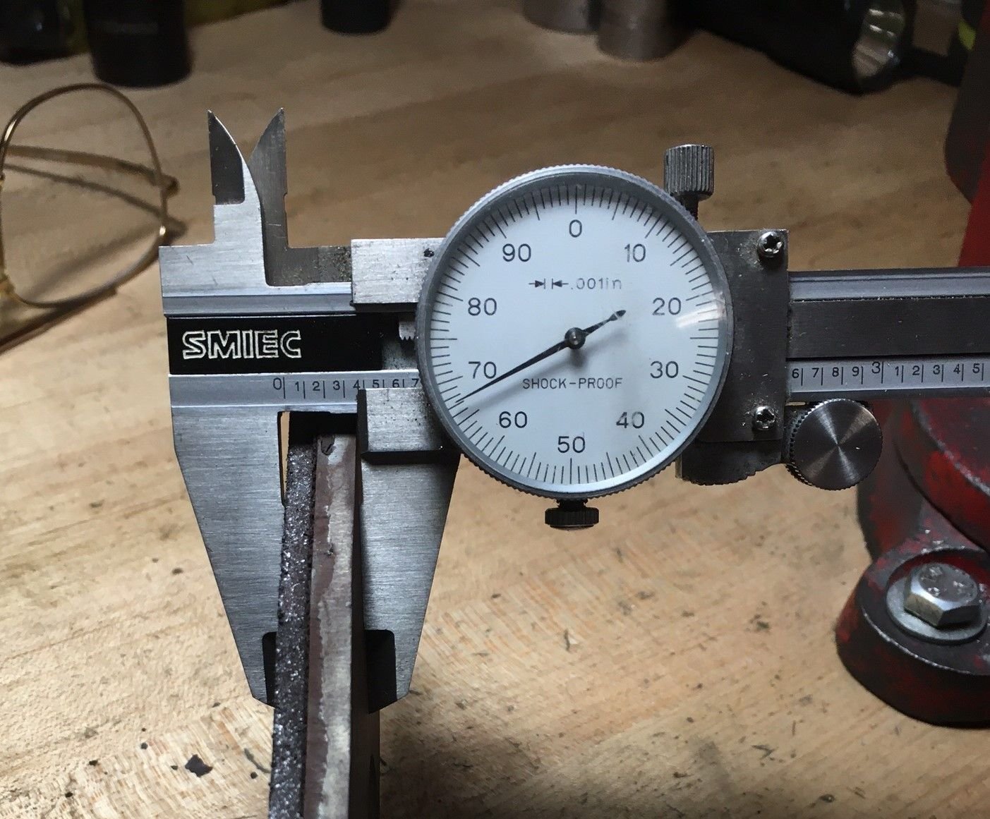

New HP-Plus front pads measure about 0.570" thick including the steel backing (0.205"), so net new pad thickness is about 0.365".
Today this thinner, worn old front pad measured 0.367" total, or just 0.160" of pad remaining. NOTE TO SELF: change the pads sooner next time! The pad friction material is the heat insulator between the brake piston and brake fluid and the VERY HOT rotor on track.
