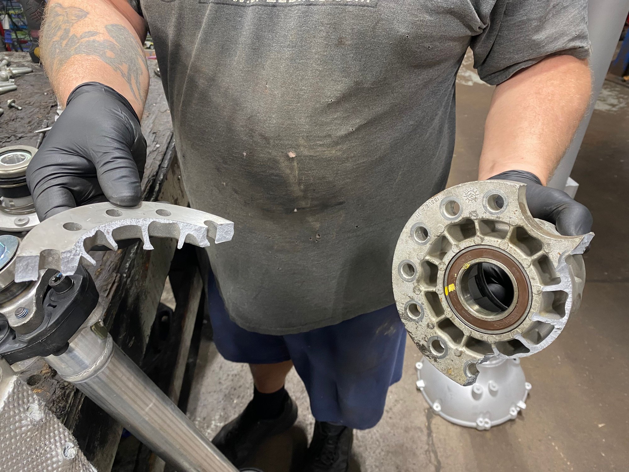

Hi everyone, so my torque tube was stuck so force was really the only option lots of corrosion and in doing so the teeth of the propeller shaft/input shaft got chipped. I can’t find any part number for it or replacements. I see that there’s an aftermarket one but it states for 01-04 models only. Does anyone know if it can be used in 1997 they look very similar or should I just clean it up and use it as is?

I did and their kit is very over priced. I’m either going to drill to 12mm or buy a used torque tube 😵‍💫

If your picture is the only damage I'd just clean it up with a small file and run it.
I was thinking that. I'm guessing the spline probably dead soft as wrought. I have had good luck with an Ogive shaped Swiss pattern file to clean splines at work. It's tedious work but can be done.That ogive shape usually takes off the raised stuff without removing excess material and scratching the rest of the spline.

Definitely worth a shot, blend it and see what it looks like... Other wise check those links I gave above.
So I ended up cleaning up the shaft and there’s lots of holes from corrosion. I thought of just running it as well but it seems like too much a risk for all this work . But definitely if that was the only damage I’d do it my mechanic also recommended I just file it.
