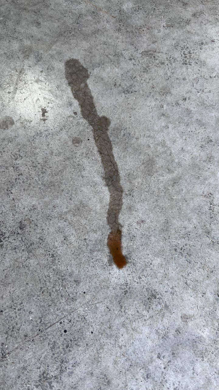

Centered under rear axle. Had been parked for about a week. Guesses?

Do you have a dog?

looks like dirty trans fluid

The seal between the trans and diff is leaking.
Tough fix?

That's my guess.
You'll need to remove the rear. Probably 4-8 hours depending on if you're working on jack stands and experience.

Originally Posted by txkk626
Tough fix?
In a word.................yes
That's my guess.
Thank you for the insight!
