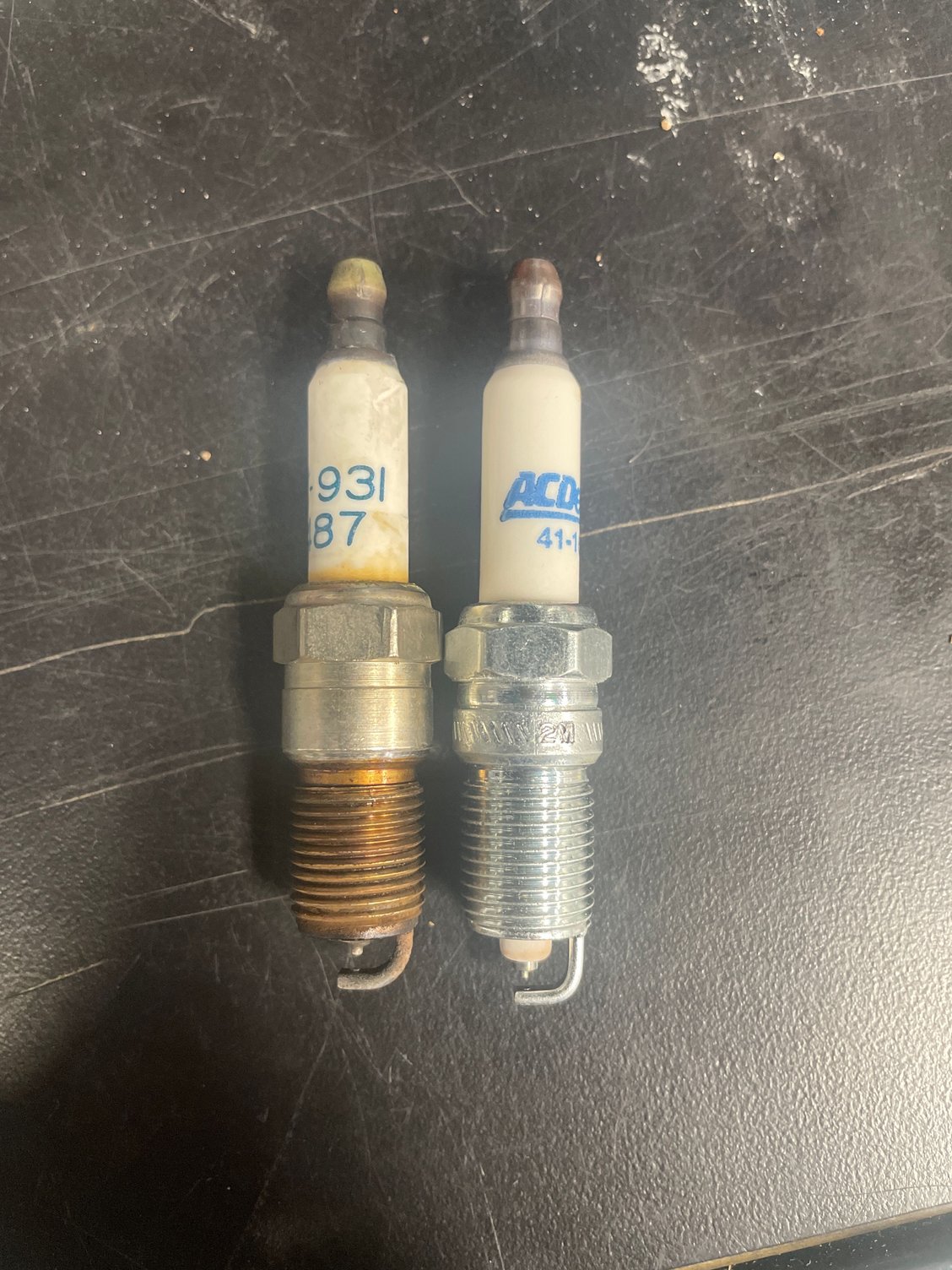

I just pulled, from my understanding, the stock spark plugs from my 1998 c5.
ac41-931
the replacement plugs I was given are 41-
i know gm has changed recommendations over the years, but I can’t seem to find clear info.
all stock motor.

To close out this thread for other people searching. Early c5 had 41-931 installed since new.
since then GM had updated what plug is recommended based on who producing for them, and what metal type. 41-931 > 41-985 > 41-110> 41-162. All work the same in ls1
