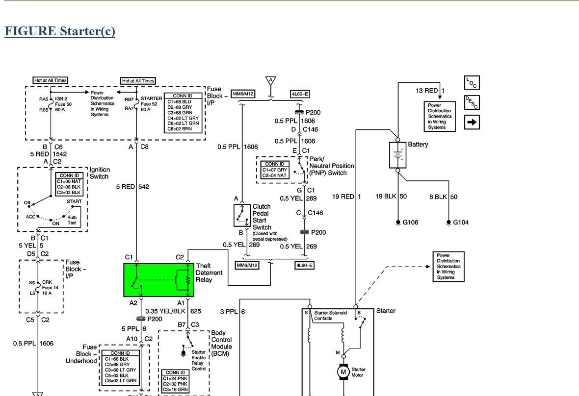

Try to measure the TDR relay in the passenger footwell.
Do you have 12 v on C1 ?
Do you have 12v on C2 which drops to 0.2-.3 volt when you turn the ignitionswitch to ACC ?
