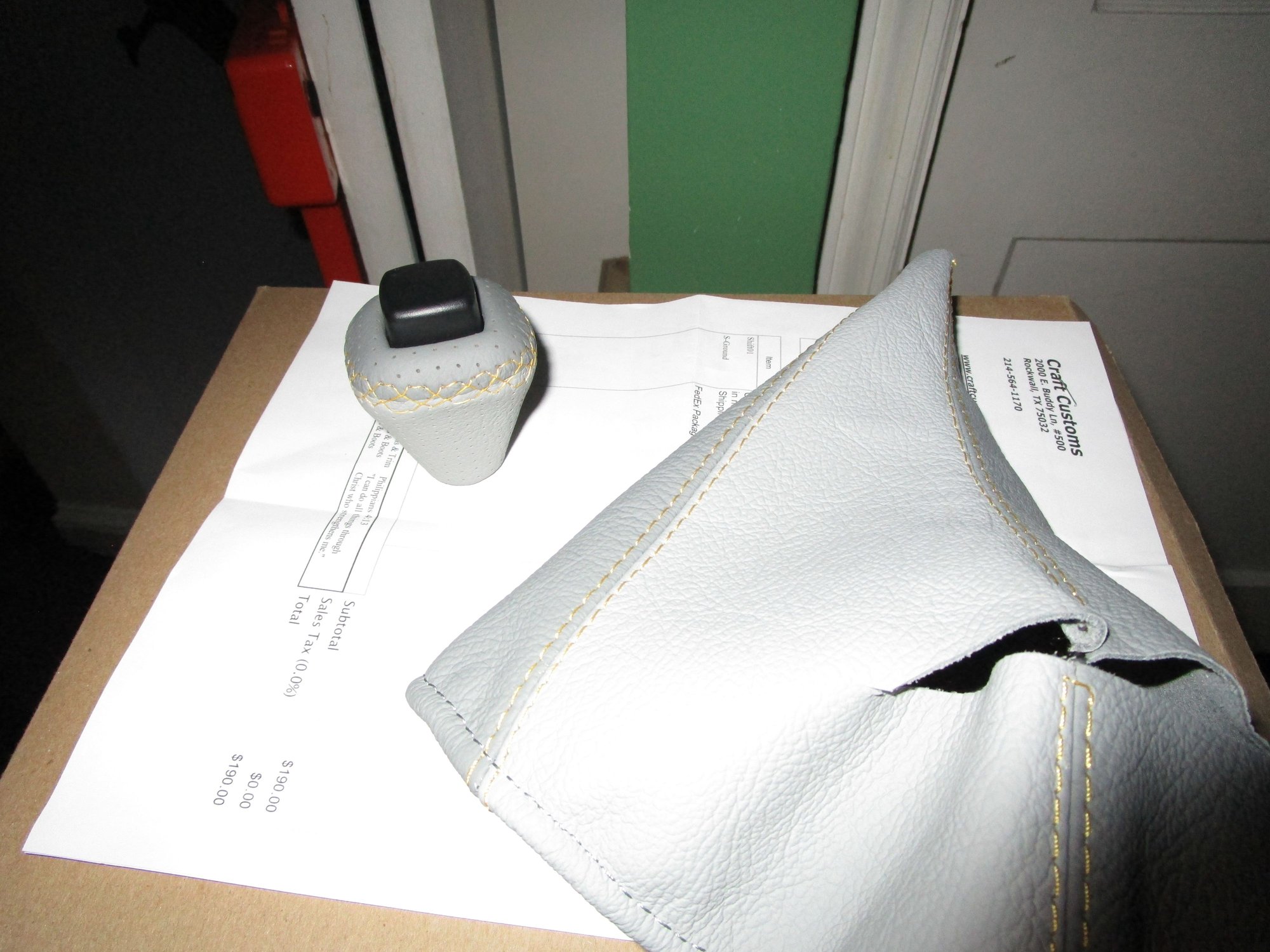

Since the snow is piling up outside, I got to thinking about a "Spring-time" job and I thought I'd ask the experts, I bought a custom 4L-60 automatic shift boot from Redlinegoods.com, and it seems like the new leather is somewhat thicker than the 2003 OEM shift boot material and I was wondering if this is going to pose a problem come install time ? I also haven't been able to find the plastic retainer that holds the new shift boot to the gear selector fixture. Any advice is greatly apricated !

You need to overlap the edges of the slit in the boot over the long oval retainer. Look at the old one to see what I am talking about. The slit in the boot I got had to be enlarged quite a bit. I glued the leather to the retainer with E6000 cement. It was nearly impossible to hold in place until I remembered that I had a lot of small hemostats that I could clamp it with. It is especially difficult (and critical) to get it properly glued at each end. In case you don't already know; there is a staple in the front of the shift **** that you need to pry out so you can remove the ****, then, turn the old boot completely wrong side out to reveal the zip tie at the top that keeps the boot fastened to the shift lever.

I just stumbled on another problem with this RedLineGoods shift boot, and that is at the top of the boot, there isn't any clear way to have a ZipTie to close the boot around the shifter itself, how are you doing that ? . . .
Killain
You have the OEM style shift ****. I've converted mine to a ball style. The adapter for the conversion fits over the shifter and it is a larger diameter. I tried using a ziptie to secure the boot, but then the folded over leather would not fit inside the OEM grommet. So I abandoned that and just shoved the leather up into and over the top of the grommet and locked it down with the shift ****. If it doesn't hold, I'll add some glue, but it seems pretty solid.
The opening at the top of the new boot was too small to fit over the adapter, so I cut off about 3/8". It worked as far as that goes, but I find I can no longer put the shifter in 1st. I don't go there anyway, but it's disappointing. If I had it to do over again, I'd just push it down hard over the adapter instead of cutting.
For you, I think this suggests putting the zip tie as close to the top of the boot as you can. Don't take my word; fit and try!
One thing you will encounter is that the bottom of the boot fits exceedingly tight around the base. I decided to cut off the little aligning tabs that go through holes in the OEM boot. That helped.
Boot inverted to install zip tie
