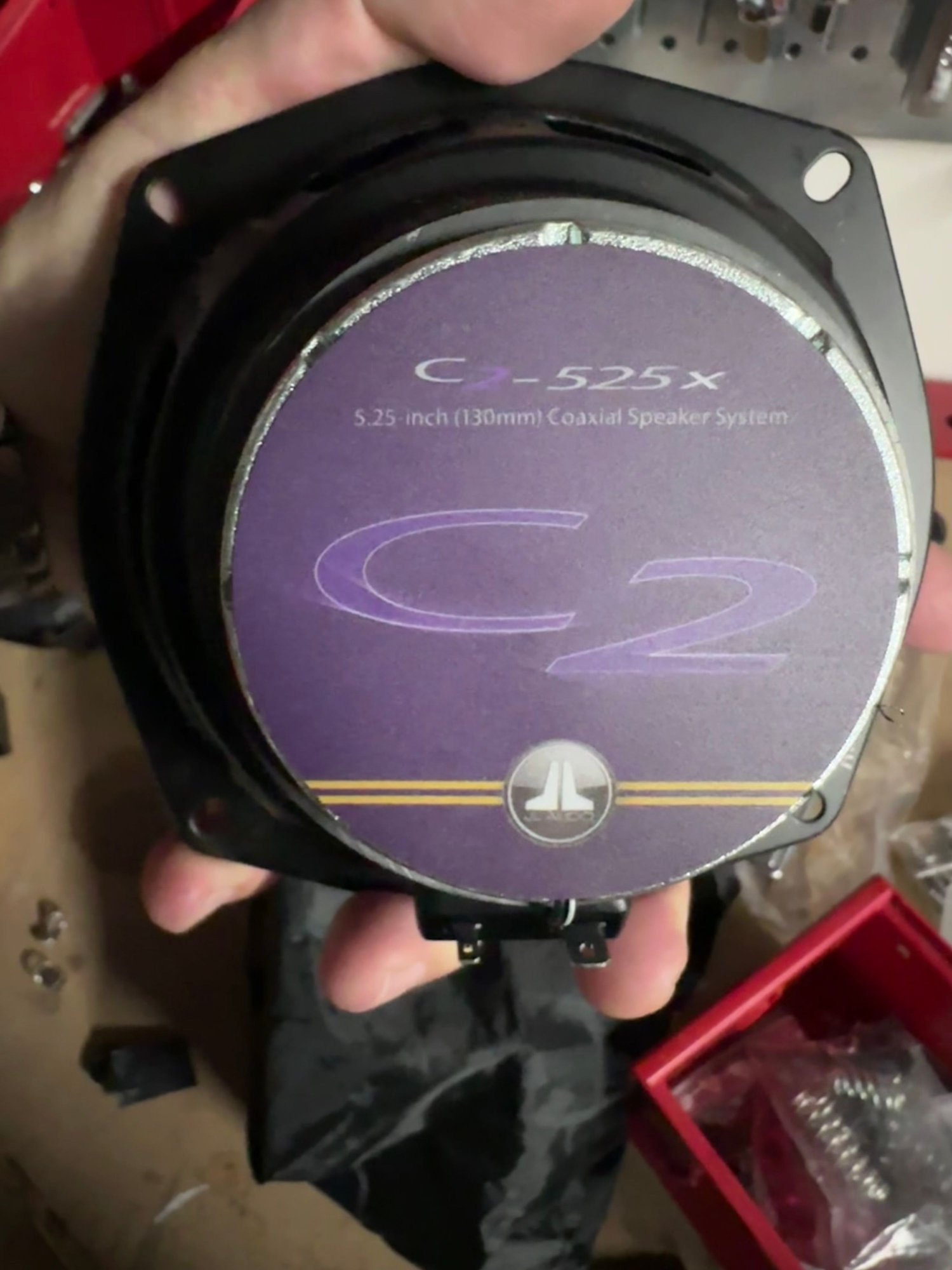

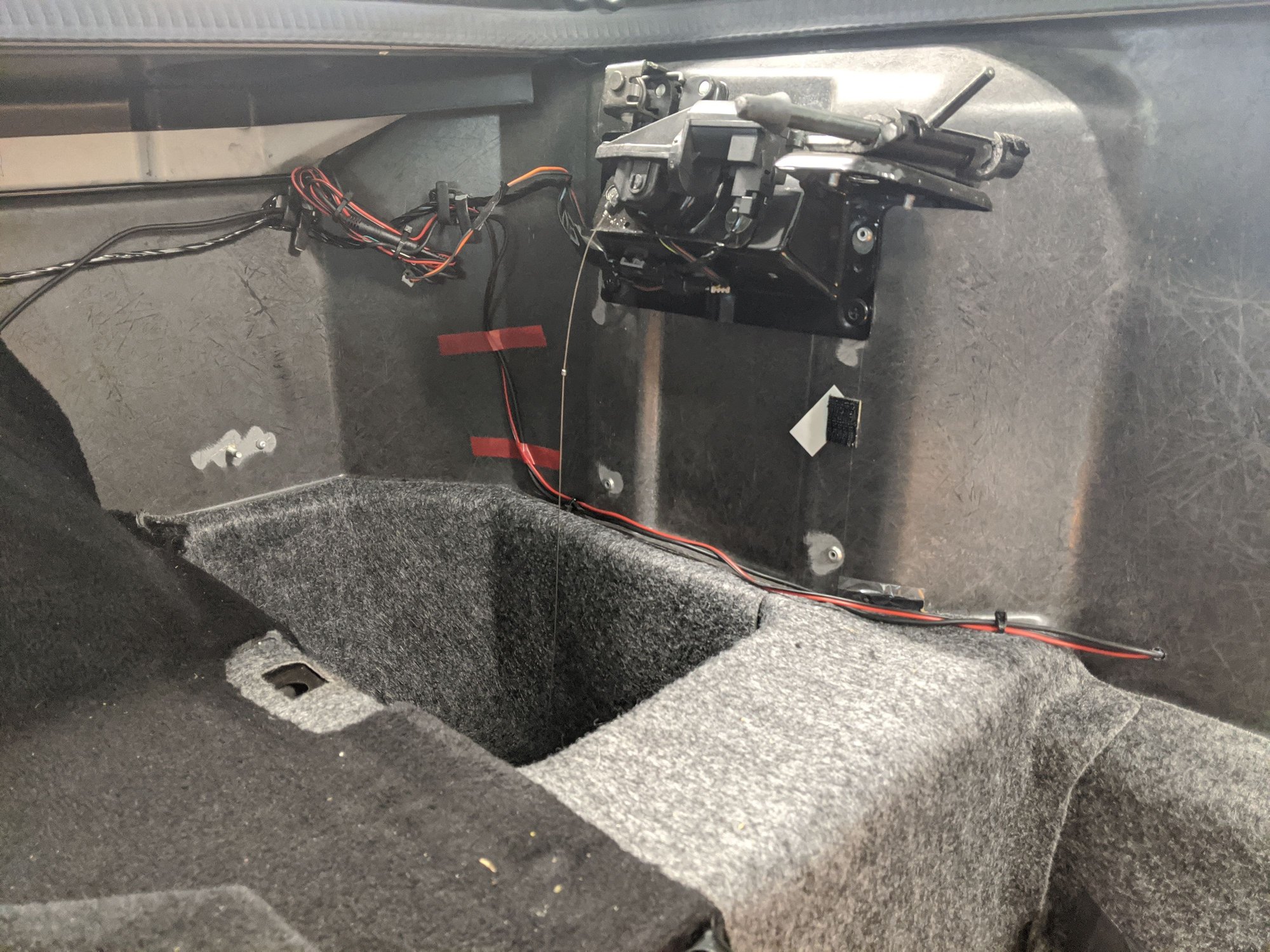

Sure.

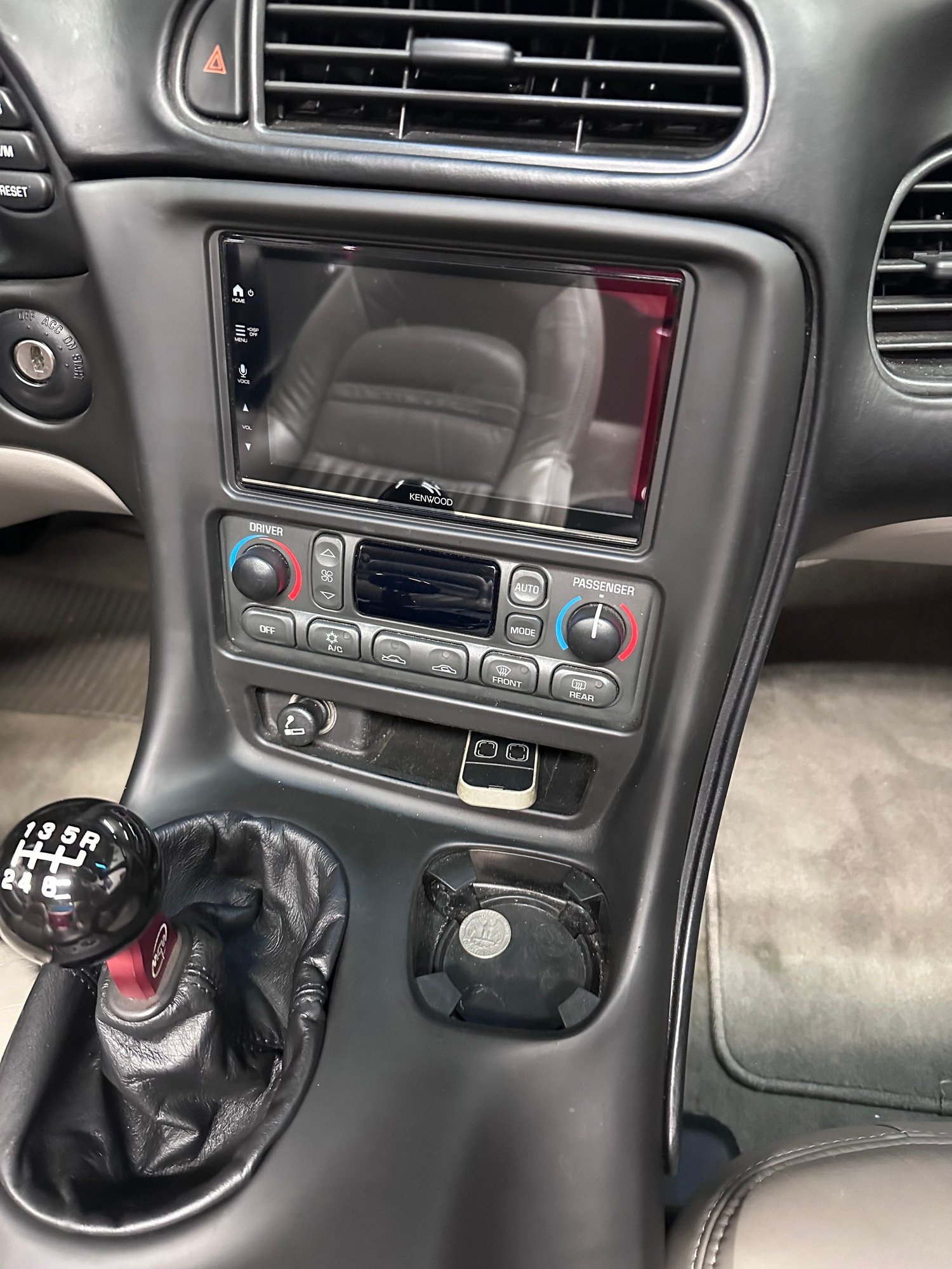

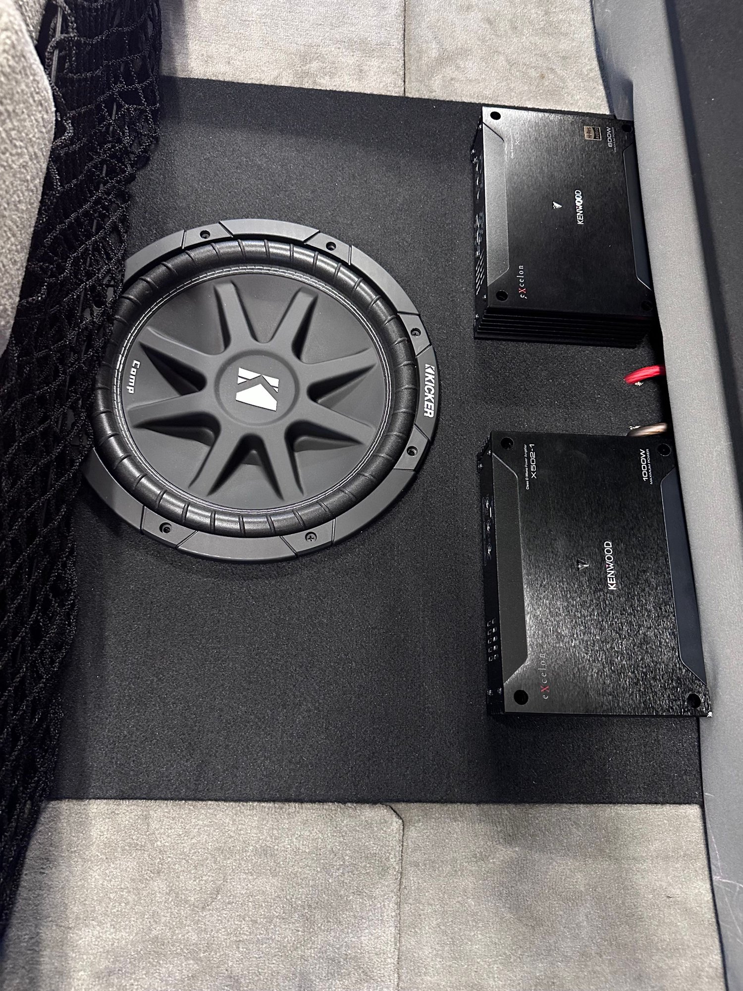

System consists of:
Kenwood DMX8709S double din media player
Kenwood X302-4 50Wx4 channel amp
Kenwood X502-1 500Wx1 subwoofer amp

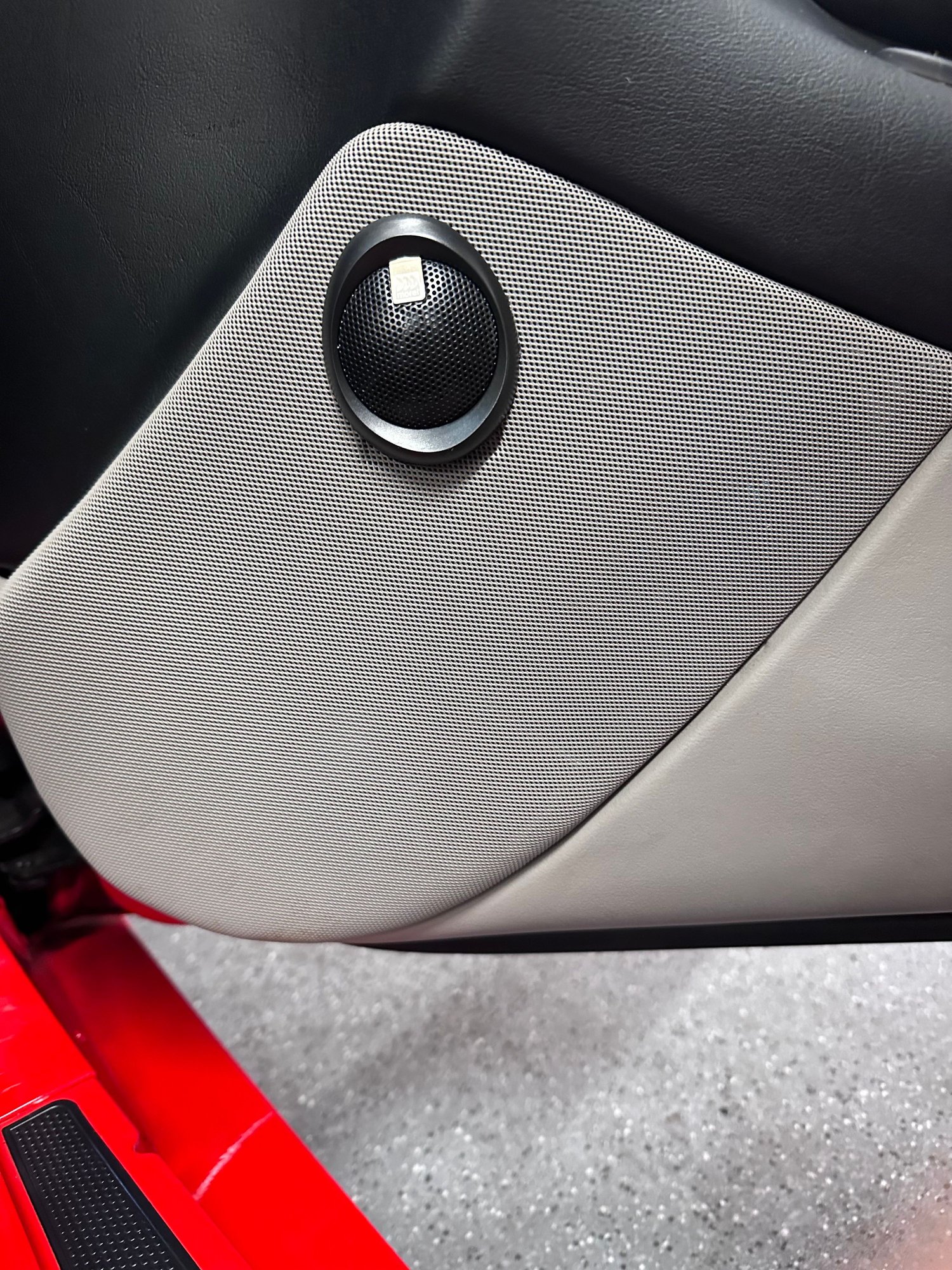

Morel Maximo Ultra 602 6-1/2” 2-way component speakers-front
Amazon door speaker templates
JL Audio C2-525x 5-1/4” 2-way speakers-rear
Kicker 43C124 12” 150W subwoofer in custom fit enclosure from Here

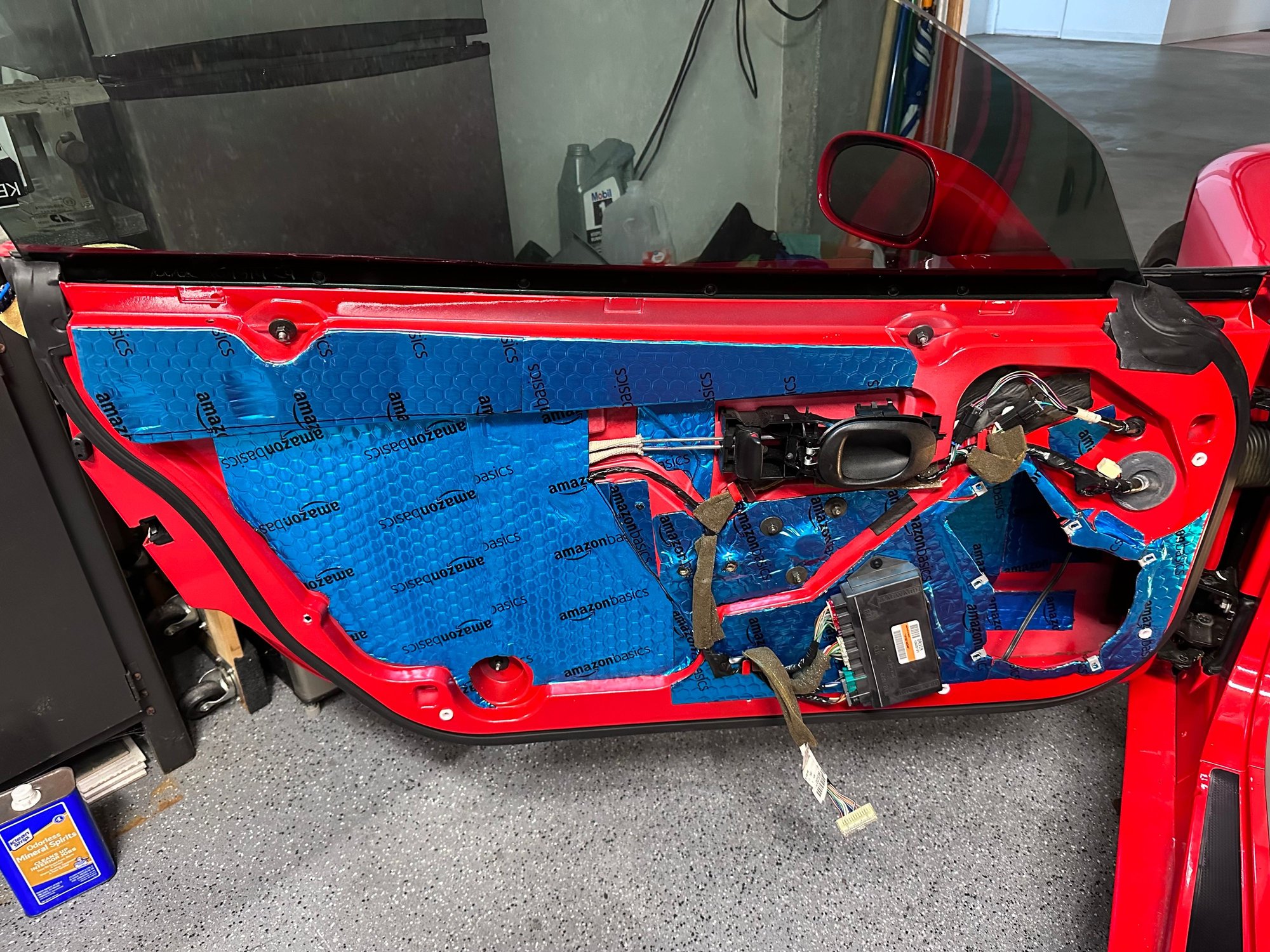

Also includes Amazon basics dynamat in the doors, various cables, wiring, terminals and fuses.
install pics:
Double din bracket
Door templates
Door speakers/tweeters installed
Custom fit sub enclosure
Rear speakers
Dynamat
