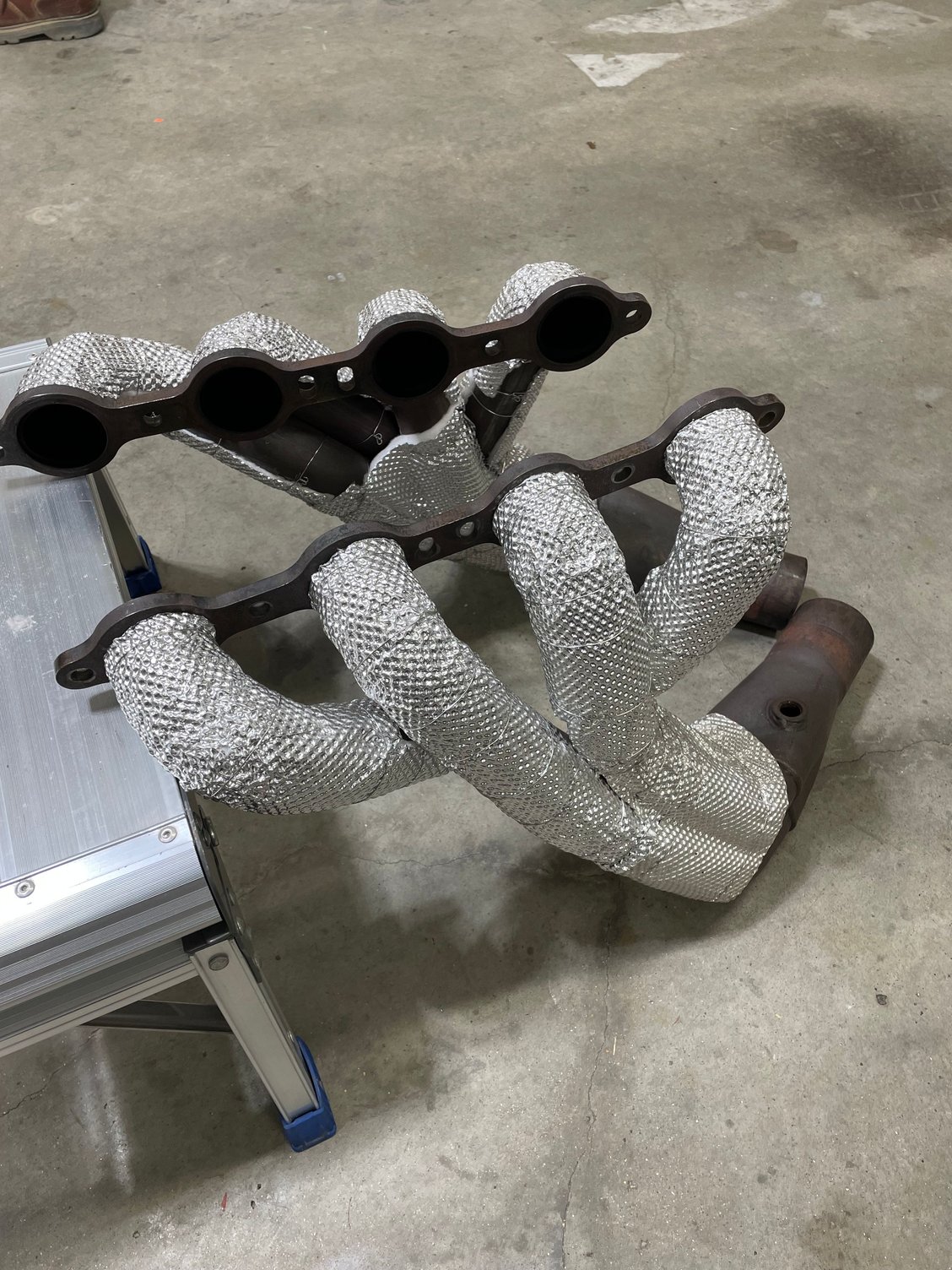

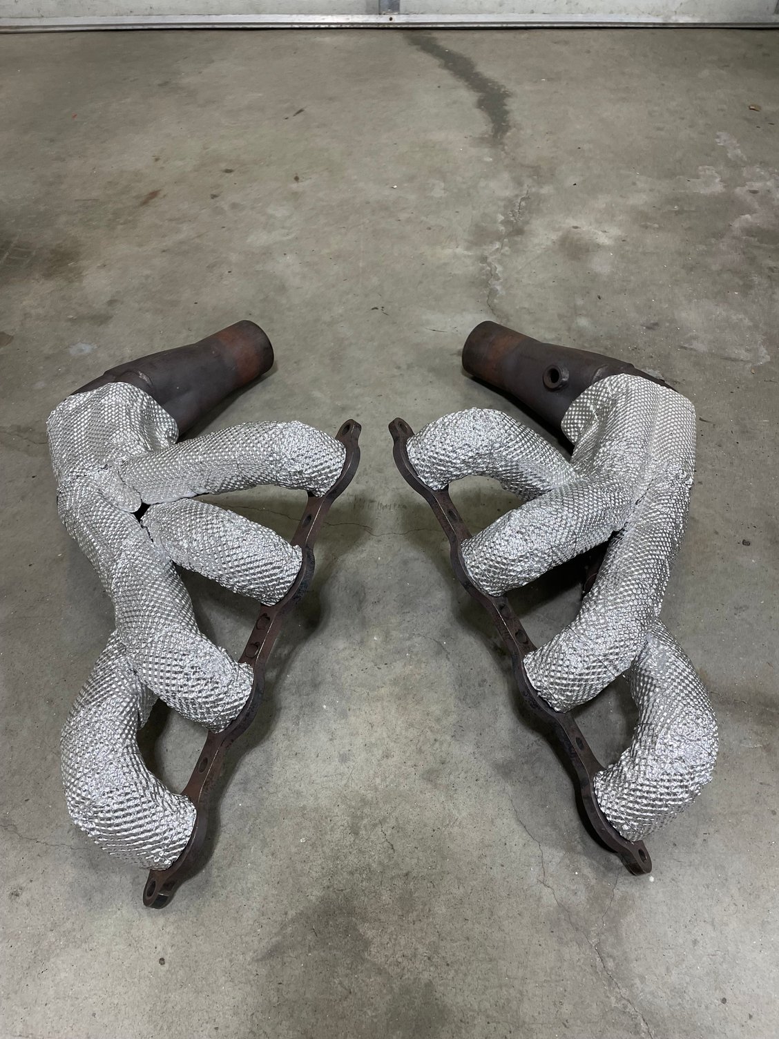

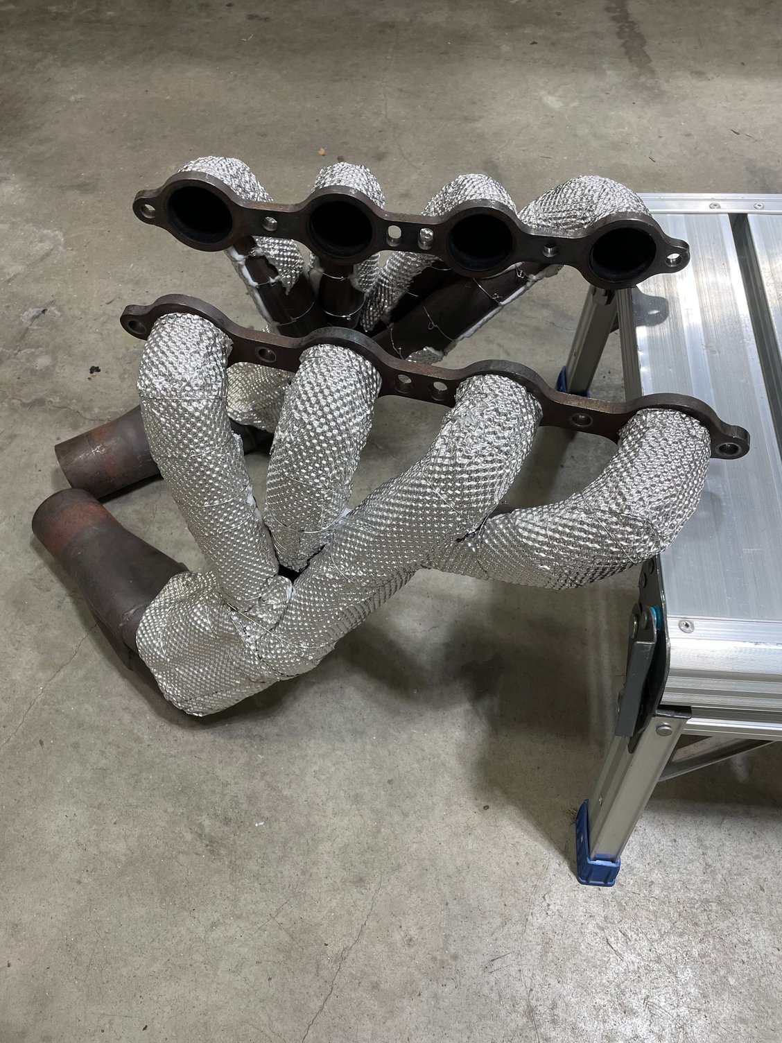

I went a little nuts:
I used this:
https://www.heatshieldproducts.com/heatshield-armor
Slightly tedious but turned out well. I used stainless safety wire to secure it to the headers.
I used this:
I found the exact same product last night, it looks promising. It also seems like it would have less rust issues than wrap because its open no one side. Have you been able to install them yet? I'm very curious to see how well it does!
