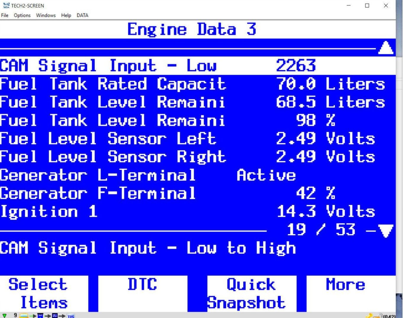

You have probably one or more of these codes.
These codes are SET depending on how the voltage signals from each levelsensor behave when you consuming fuel.
The right right sender drops voltage when when fuel level decrease until it's empty and then the left sender decrease the voltages when fuel level decrease .
If these voltages levels not behave correct the DTC code set and the level indicator drops to zero level as a warning.
Blocked fuel ine between both tanks could cause a DTC indicating a faulty level sender .
I recommend viewing the sensor voltages on a Tech2 or similar scanner to observe whats's happening instead of guessing .
If the siphron line is clogged is will not help to replace the level sender.
