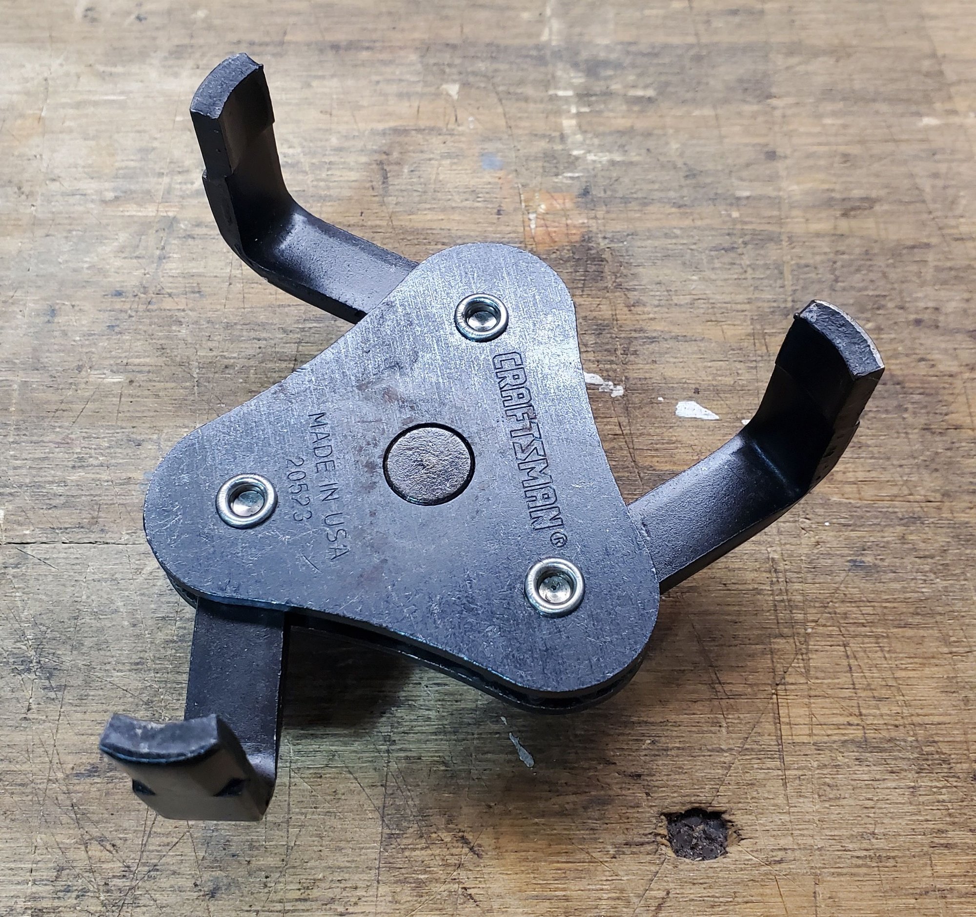

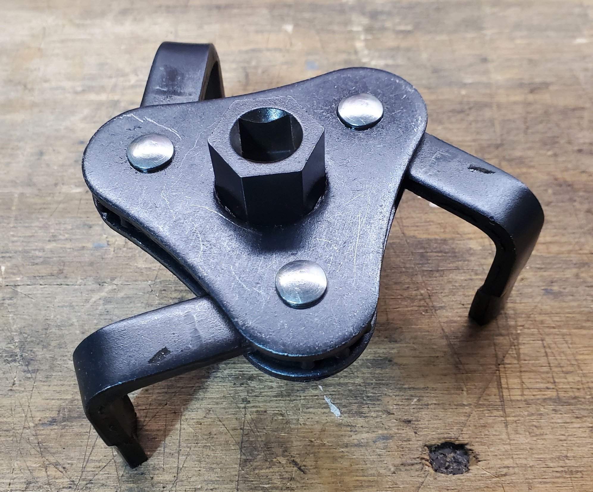

This bad boy will take off any filter from 2-1/2"-5" diameter, guaranteed

I was going to suggest that as well.

One just like it my top drawer. If only they still made and sold them. Just chinesium versions out there now.

I purchased two of them when the local Sears hardware store went out of business. Best filter removal tool I've ever used.

I think mine is Snap-On. They probably still make it.

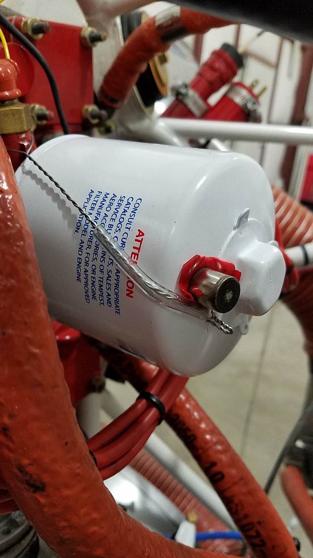

Disposable filters, I just use very old, large, Channel lock pliers. I have never used a wrench to tighten a disposable oil filter, ever. Oil the rubber seal, tighten as tight as you can with oily hands. Never a problem, plus you can remove them the next time. You can also add an strong neodymium magnet to the bottom of the filter if you do not have a magnetic drain plug.
This is a horizontally mounted OF on a Lycoming O-360 airplane engine. Tape added between filter and magnet to avoid fretting
Arrow points to debris collected by the magnet not trapped by filter media. This is an airplane engine, but the idea is the same. This engine doesn't have a magnetic drain plug.

Adding the magnet to the filter is a pretty cool idea. The knowledge of experienced A&P mechanics...

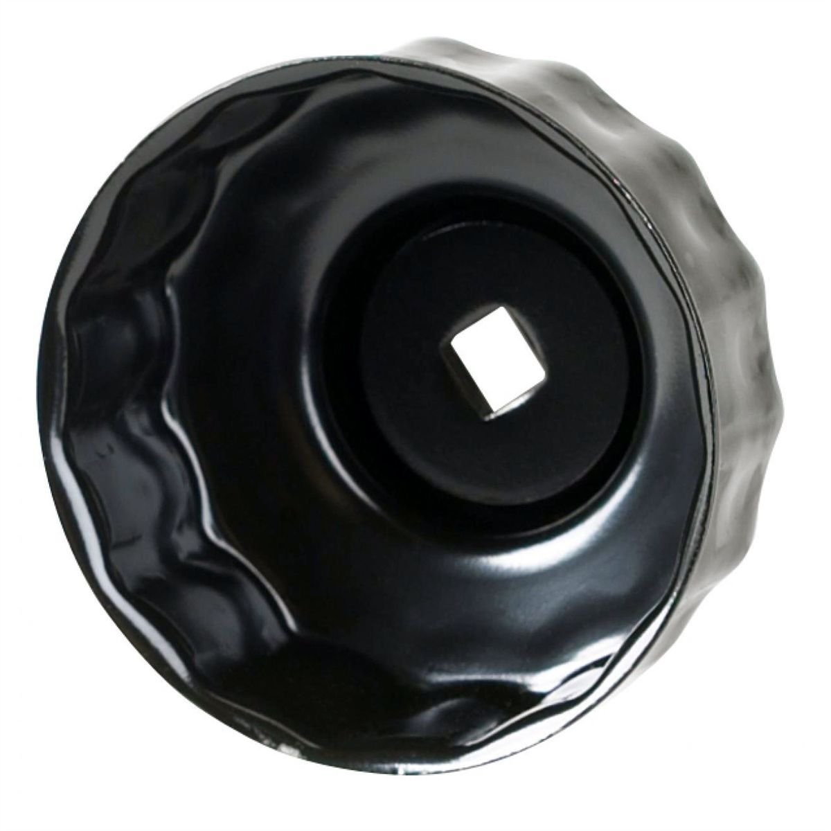

I use this kind that fits into tight places;

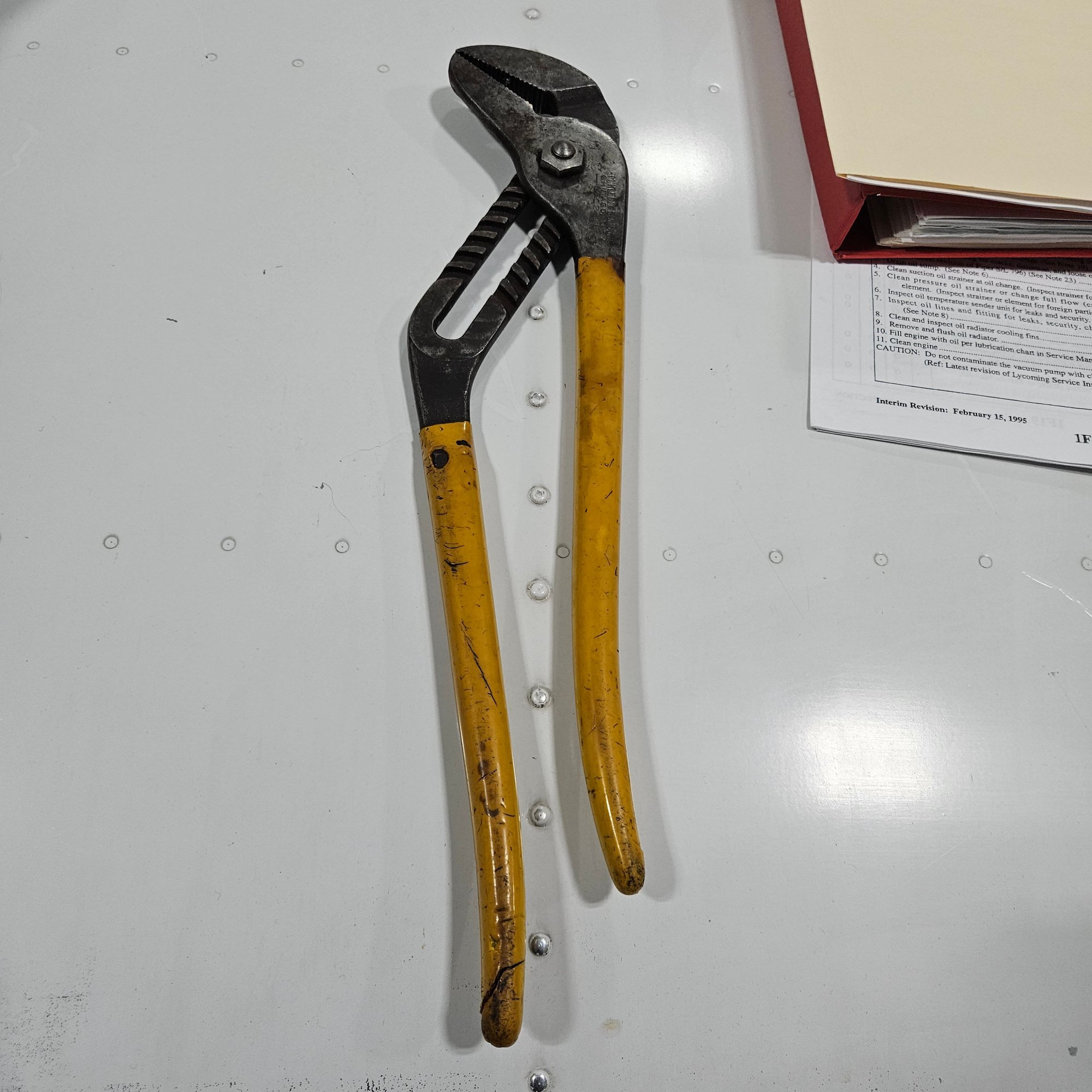

This is my oil filter wrench. for Automobiles. These are 65 years old and my father bought a set of Klein pliers as an electrician apprentice in 1959. This is part of that set. I miss him

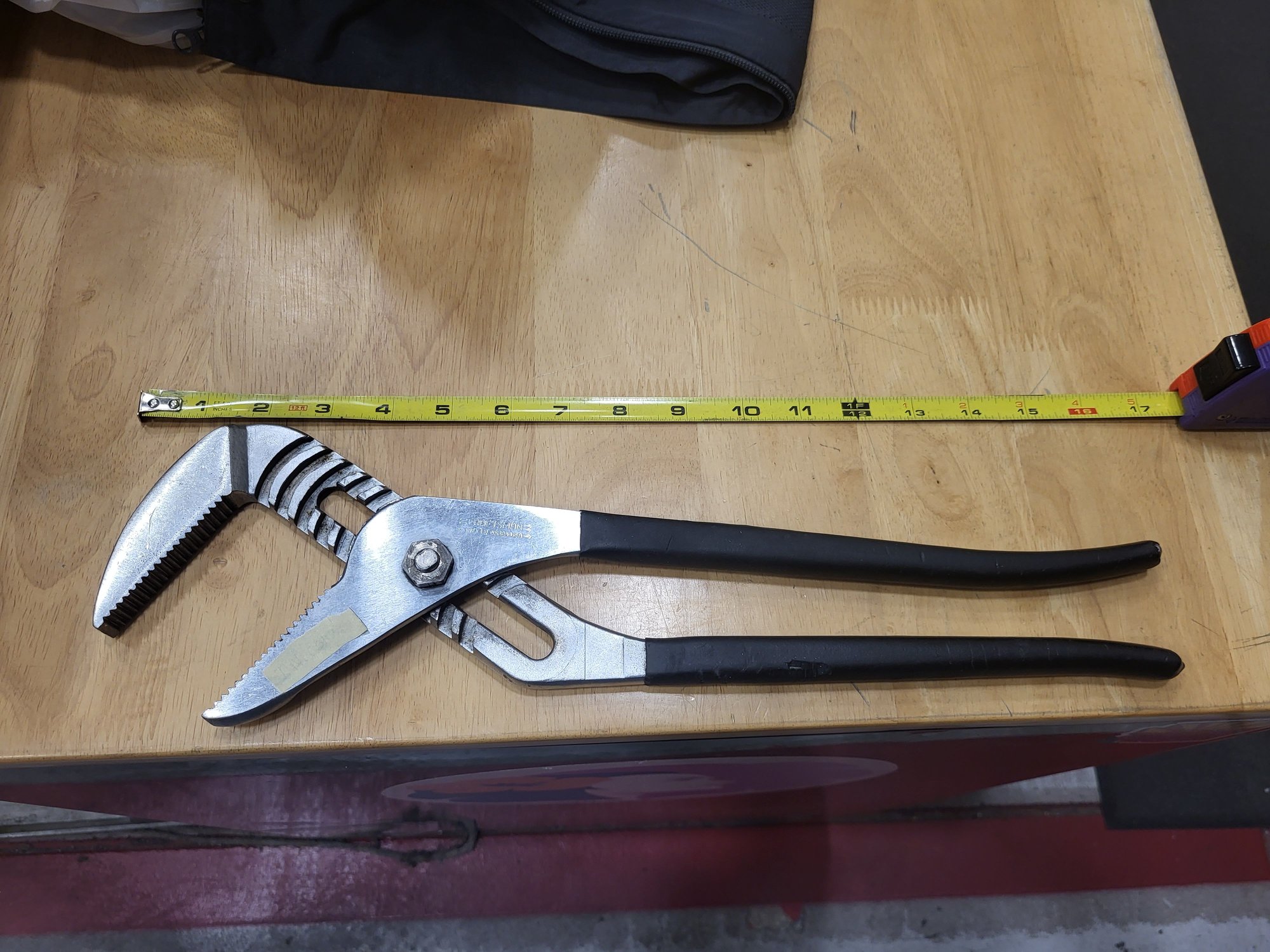

Like many of my fellow mechanics I've been using these for nearly 40 years! From back when Craftsman stuff was half ways decent. Man how time flies.

If you're going to use the one that Fast one suggests, make sure that your contact area with the oil filtre is dry, it gets a little tricky if it's slippery. These are great for applying the correct torque.
