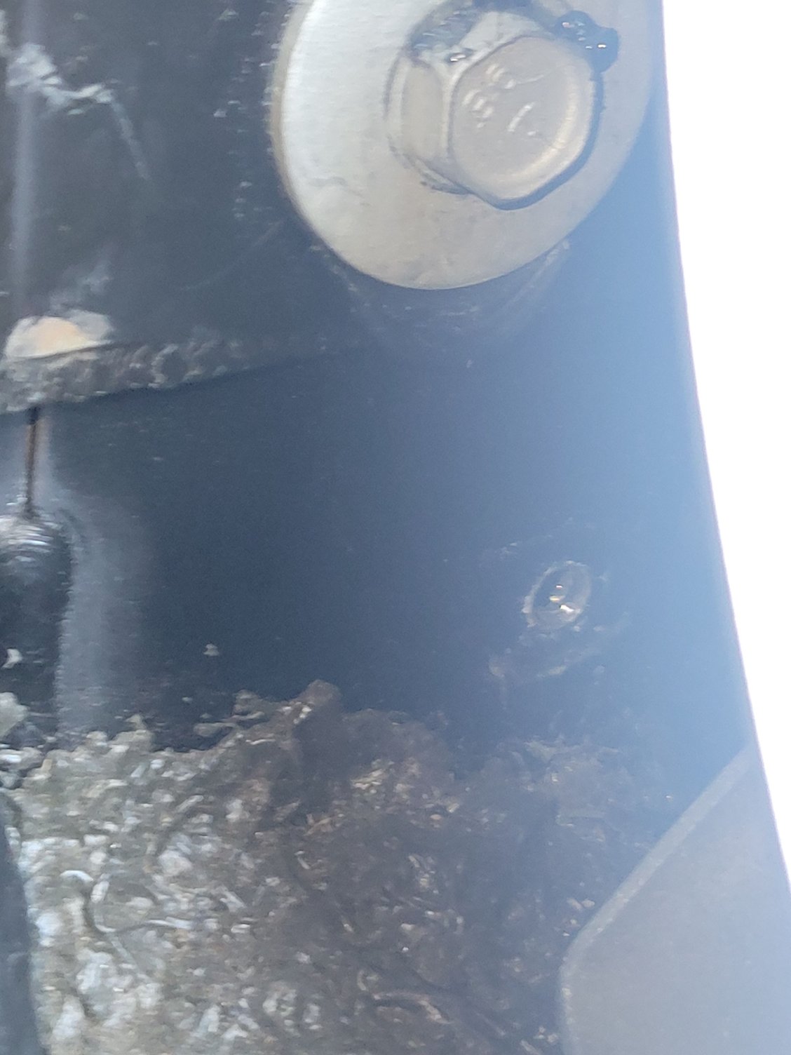

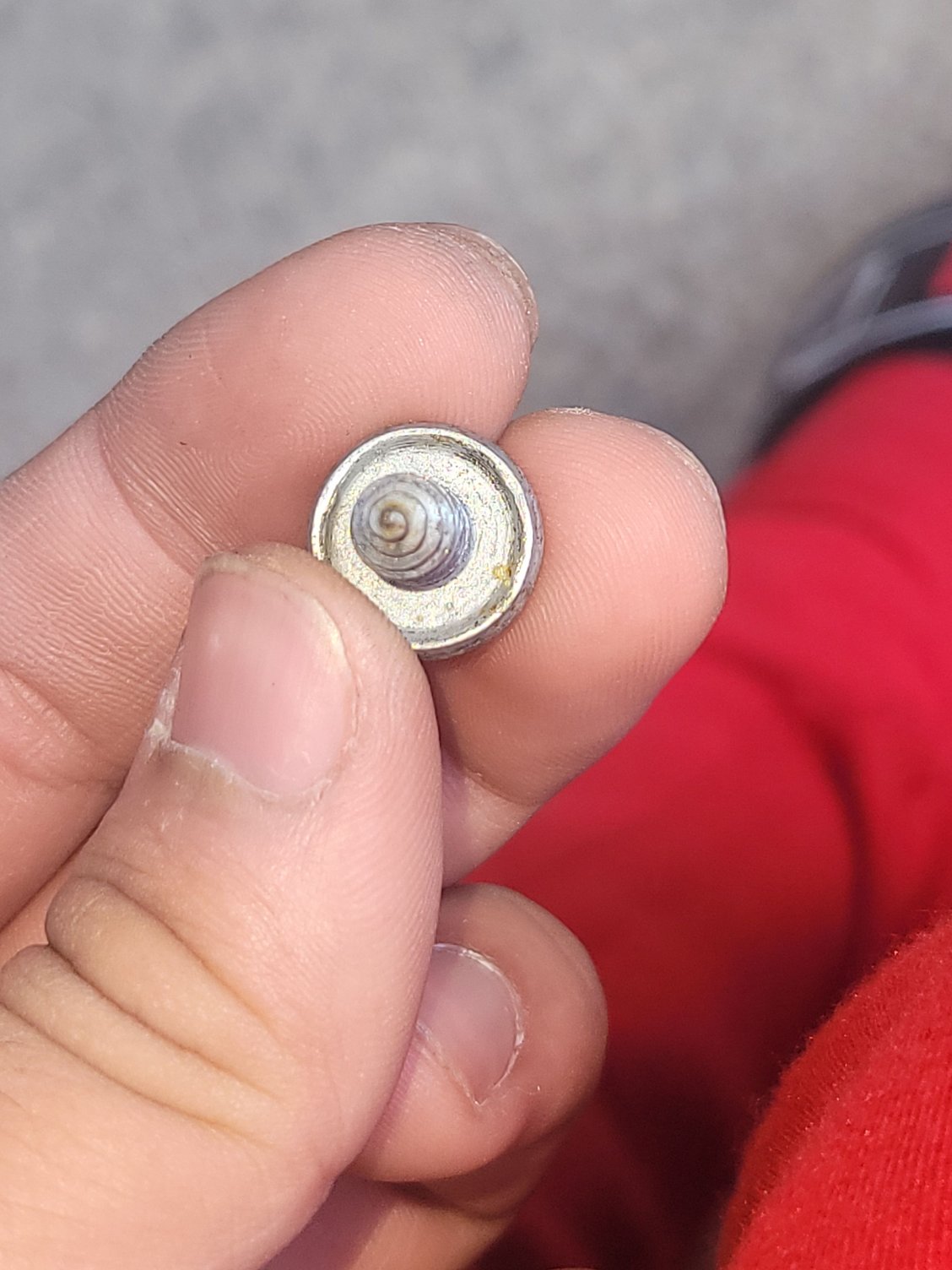

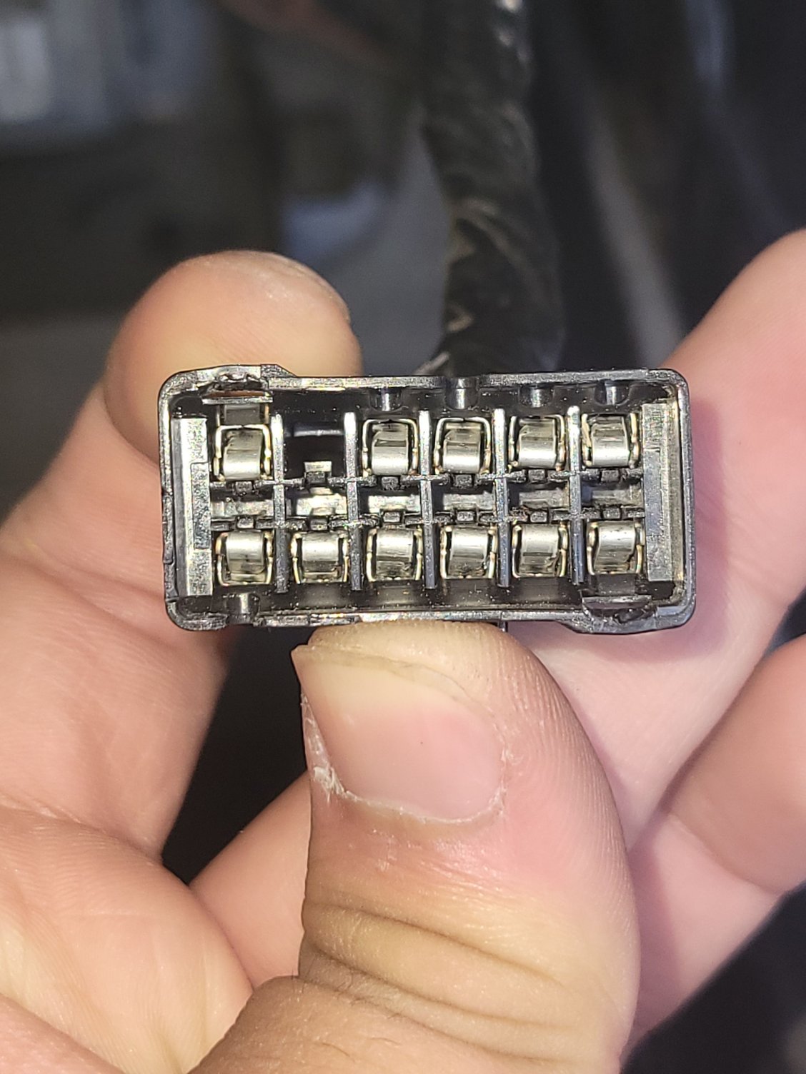

Alright so after a bit more research I found that it could be ground g202. I just took it apart and it was pretty clean.
This is the car end of the ground. I should've taken a better picture but it was fairly clean
Here is the bolt thingy, alsy clean
Here is one side of the plastic connector thingy
Here's the other side
Heres the part it connects into, also fairly clean
I've got class tomorrow so I'm going to clean it off a lil and use some silicon grease and put it together, and then drop in a new fuse and hope it doesn't blow. If it does, and I'll come back and reply to this post after I put it back together, what else could it be?
