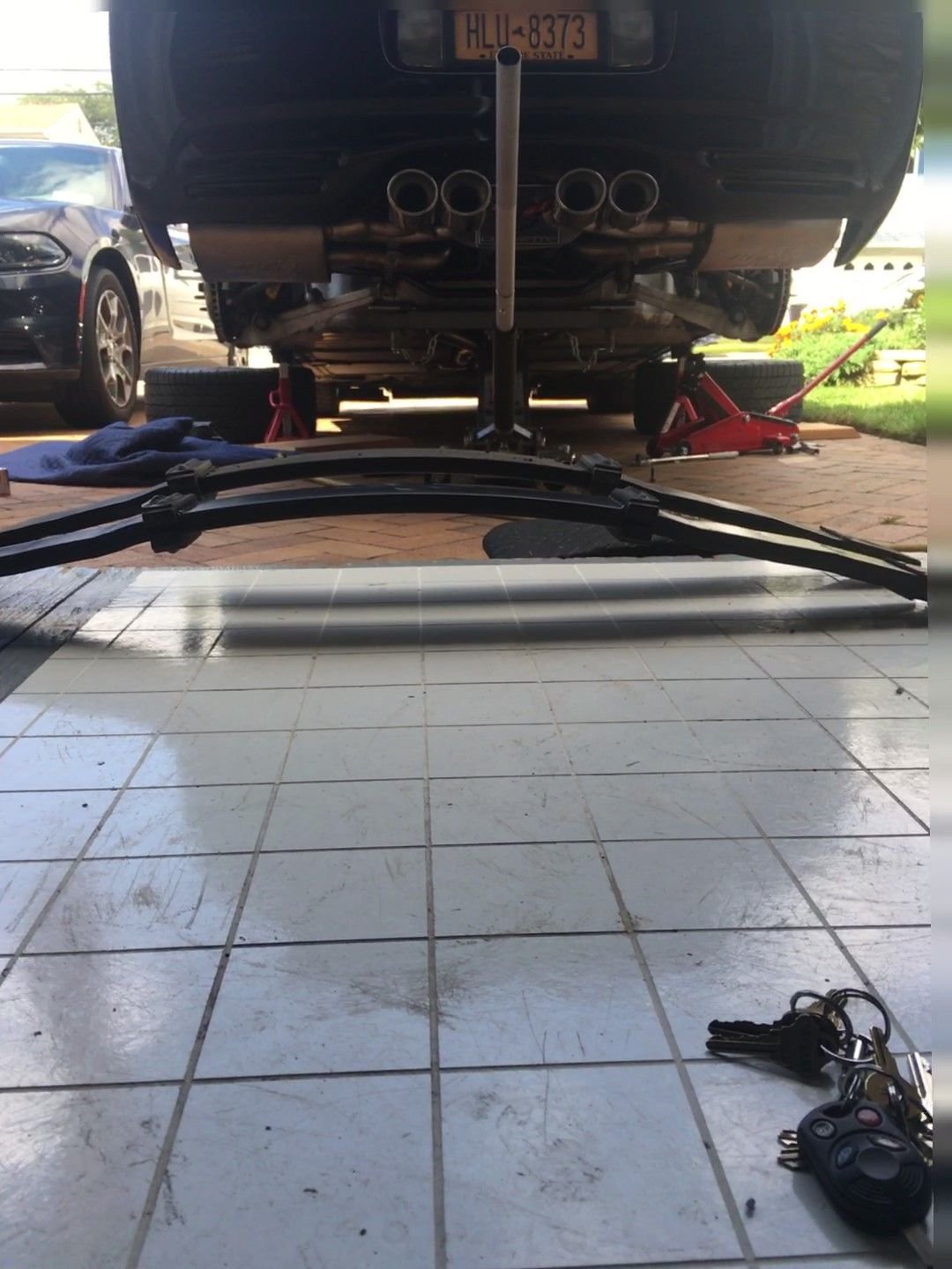

I know the rear is a lot easier than the front when I did both.
Raise the rear high enough fully unloaded, then use a floor jack to support the spring
This was before I got my quickjacks
