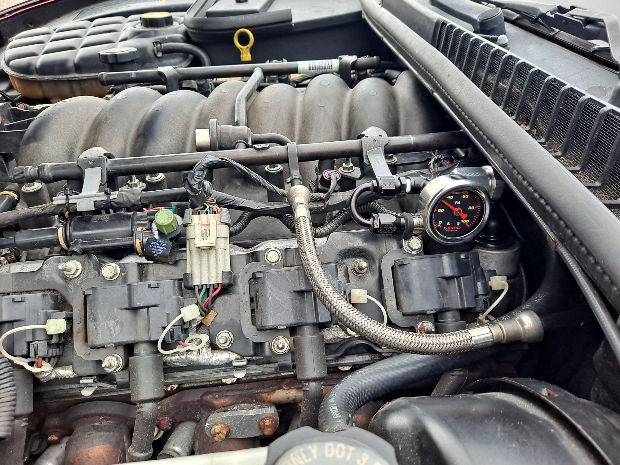

When you do replace the sensor take the time to relocate it, when, not if, it goes bad again it is much easier to replace. There are kits available or make your own as I and others have done. If you're not married to the plastic engine covers you can also include a mechanical gauge under the hood to always know the pressure right at the source. There are others who have a gauge with the covers still in place as well. I am not a fan of the covers, here is mine with the mechanical gauge.

From a convenience standpoint, another concern is a scenario where the oil pressure sensor fails low. In this situation, the PCM may default to a fail safe mode, which will make driving the care very challenging! This is why many folks recommend an oil pressure sensor relocation kit for the sensor. In the event that you find yourself stranded on the side of the road with "low oil pressure" due to a failed sensor, you can easily replace the sensor, rather than having the car towed.
