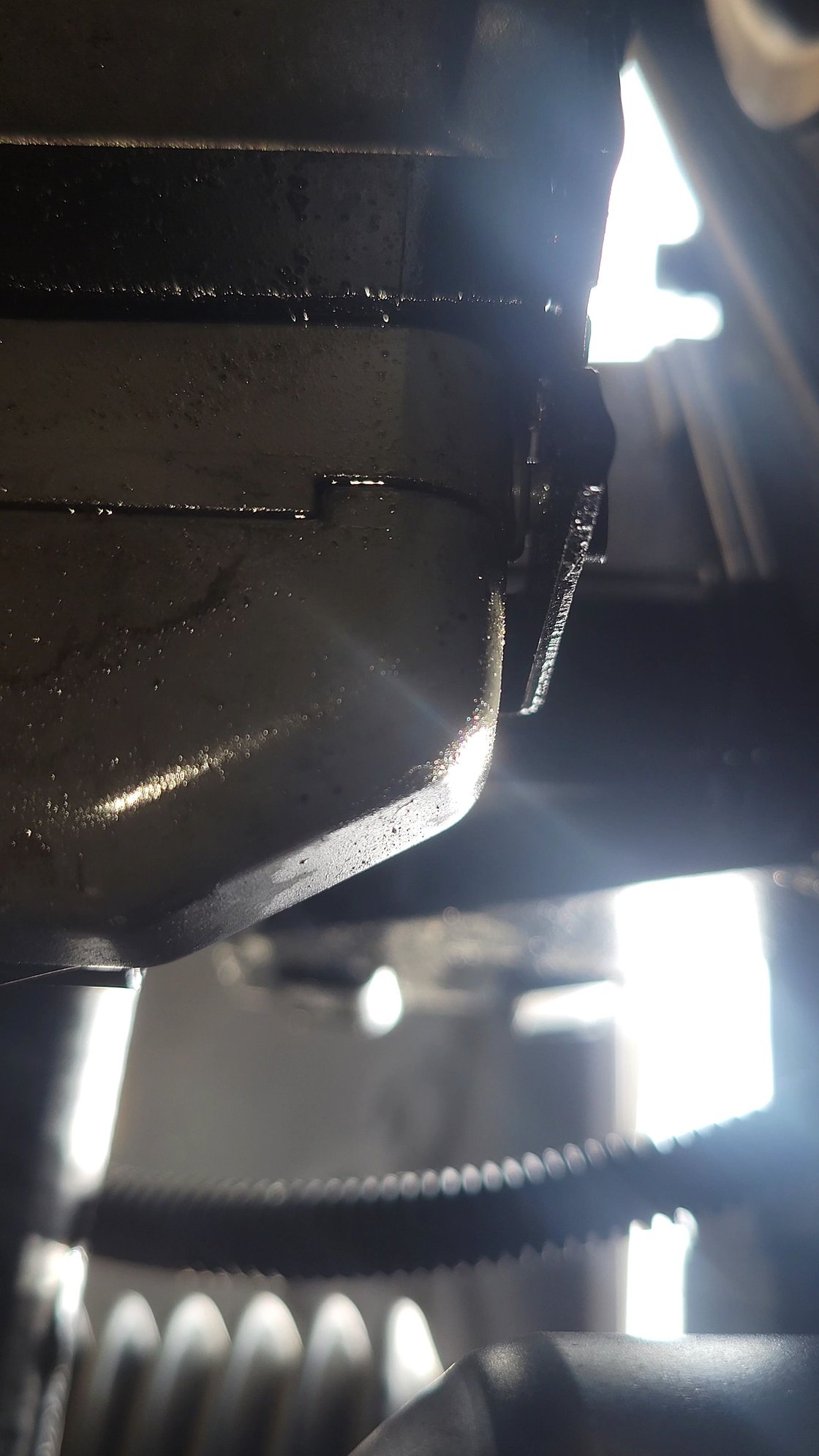

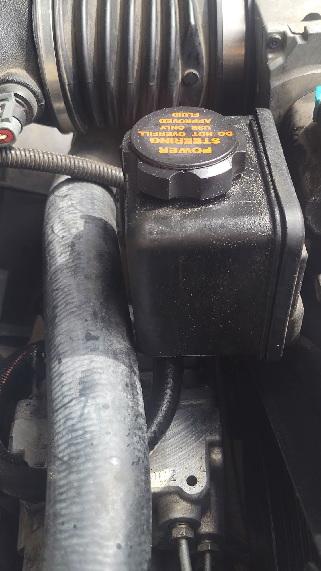

I just looked around my engine bay for a moment and could this be coming from my steering? I started my car up to take a look and after I turned it off I noticed my power steering reservoir area is shiny like it was wet. Taking a white paper towel it was just a layer of black dust. I just uploaded a video to youtube of me just pointing my camera around, if someone could take a look at it and give me some more insight as to what I'm looking at and if this is the source of the noise, I'd really really really appreciate that. I'll also upload some screenshots from the video.

Wet top of the power-steering system
Engine mount for the pulley
On top of the reservoir
Harmonic balancer
Underneath system

If you don't hear it while the car is not moving I think you can rule out the harmonic balancer (and everything else run by the belt). That spins when the engine is running. It spins faster with more rpms.
Rock caught between a pad and rotor?
If you're testing, can you start the car, turn wheels back and forth and hear nothing out of the ordinary?
Slow circles at full lock moving left, same to the right? Any noise?
Check the level of the power steering fluid? The wetness doesn't look bad for an 80k+ mile car. Could have leaked long ago but it does look like some of it is fresh because it's not covered with dirt yet.

Looks like a PS Pump failing.
