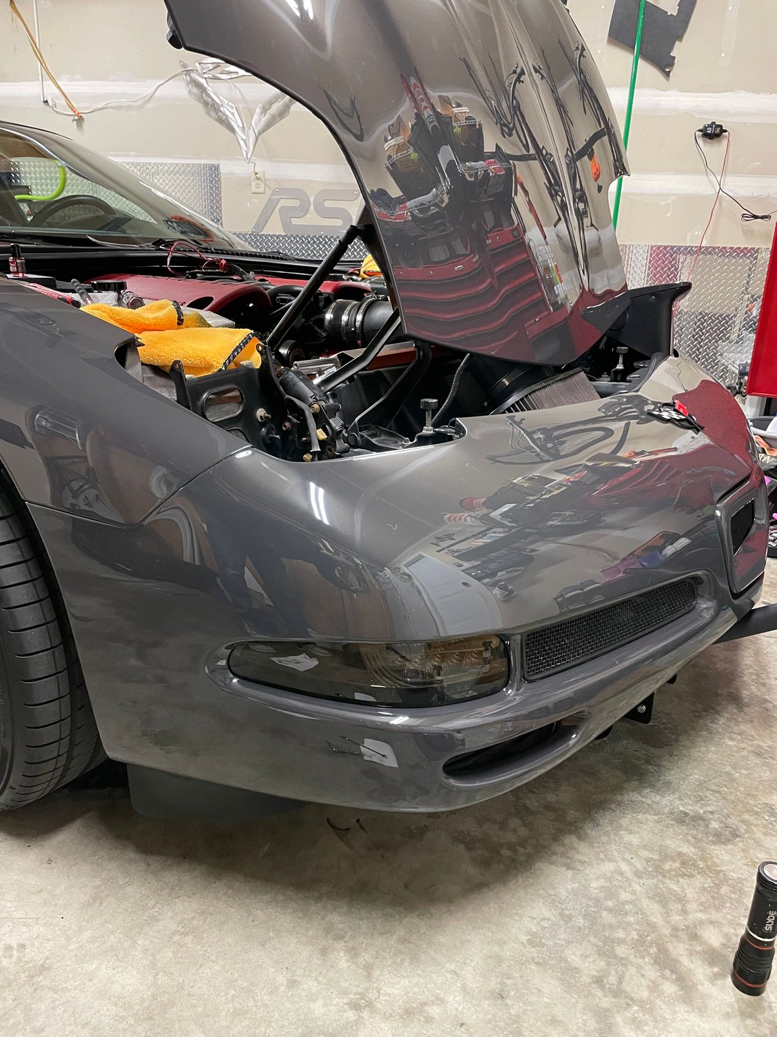

It’s that time of year to pull the car out of storage and having a difficult time making sense of what’s causing some new issues that weren’t an issue last time the car was driven months ago.
1. Noticed security light flashing and dinging when drivers door was open with key removed from ignition.
2. Headlights function, low beam, high beam and on occasion driver side will open though passenger is stuck in closed position. 75% of the time when trying to get them to open they both remain closed. There is a very audible clicking sound coming from both lights when lights are turned to off position and ignition is off.
3. Running lights flicker, though extremely dim when ignition and key are removed.
4. All rear lights operate as they should, and turn off as they should. No issue there.
Battery hooked up to a tender, car cranks and starts immediately.
4-5 months ago everything was good, no issue at all. So the question is, what would cause all of this at once? I’m leaning toward headlight module though would that cause the door chime and security flashing? Also thought about maybe the multi switch on steering column but everything functions fine other than lights flipping up. I’m confused! Anyone experience the same issues together?

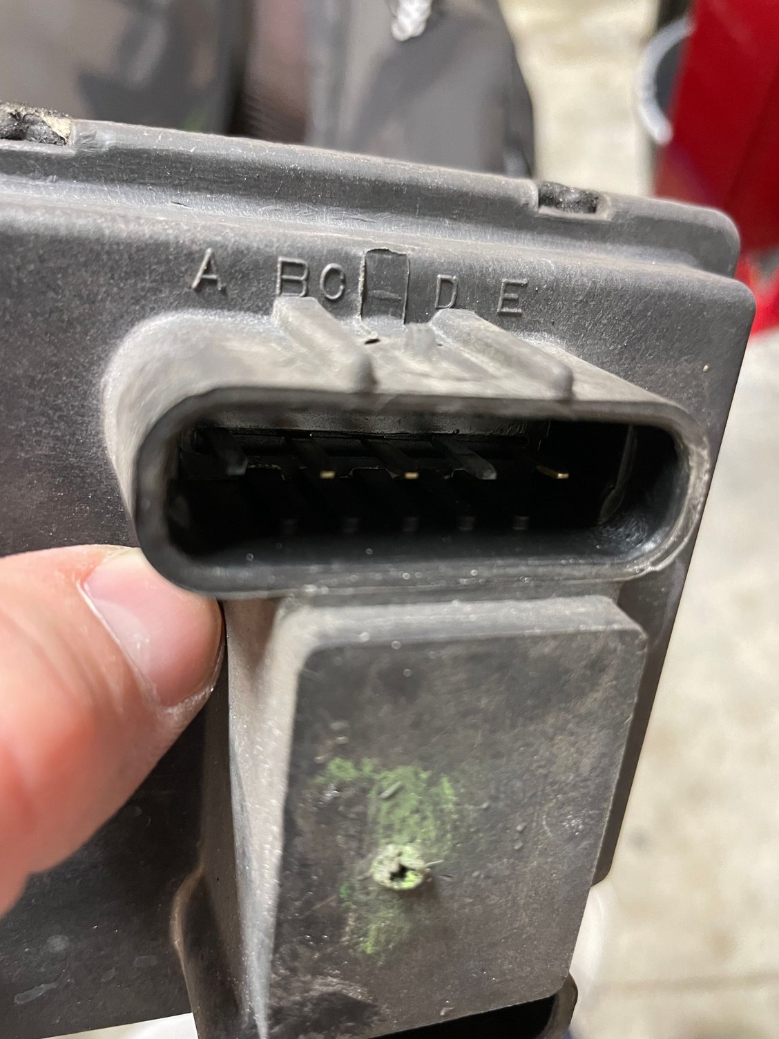

Headlight issue: Pull the connection between the motor and the module making sure the contacts are clean and tight. That is what fixed my issue.

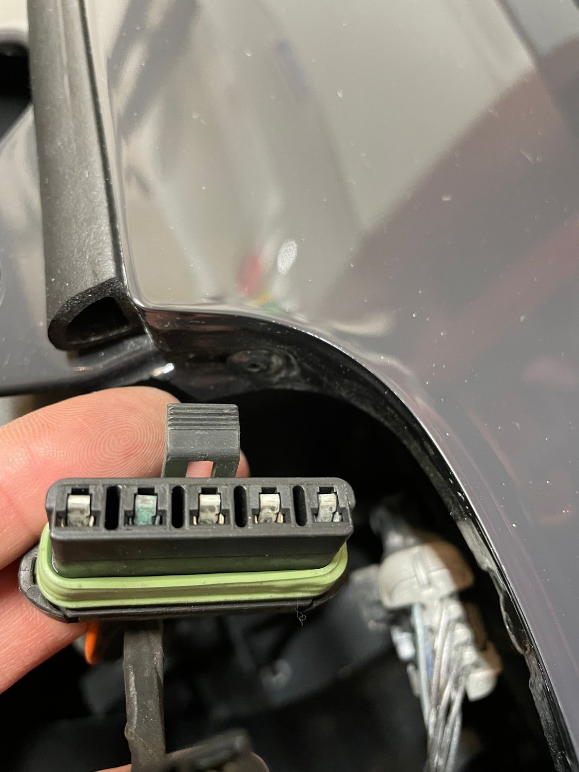

Culprit #1 - 2 of the contacts are very corroded. What did you use to clean them?

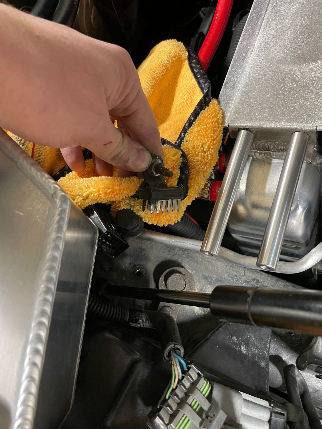

"Culprit #1 - 2 of the contacts are very corroded. What did you use to clean them?" Answer: I disconnected the negative ground from the battery that I do whenever I mess with C5 electrical. 1) use wet/dry sand paper lightly on the connectors to remove the stuff, 2) squirt CRC Mass Air Flow Sensor Cleaner in the connector to clean; 5). apply Dielectric Grease to the connectors.
After all is done make sure the connectors fit tightly. It worked for me.

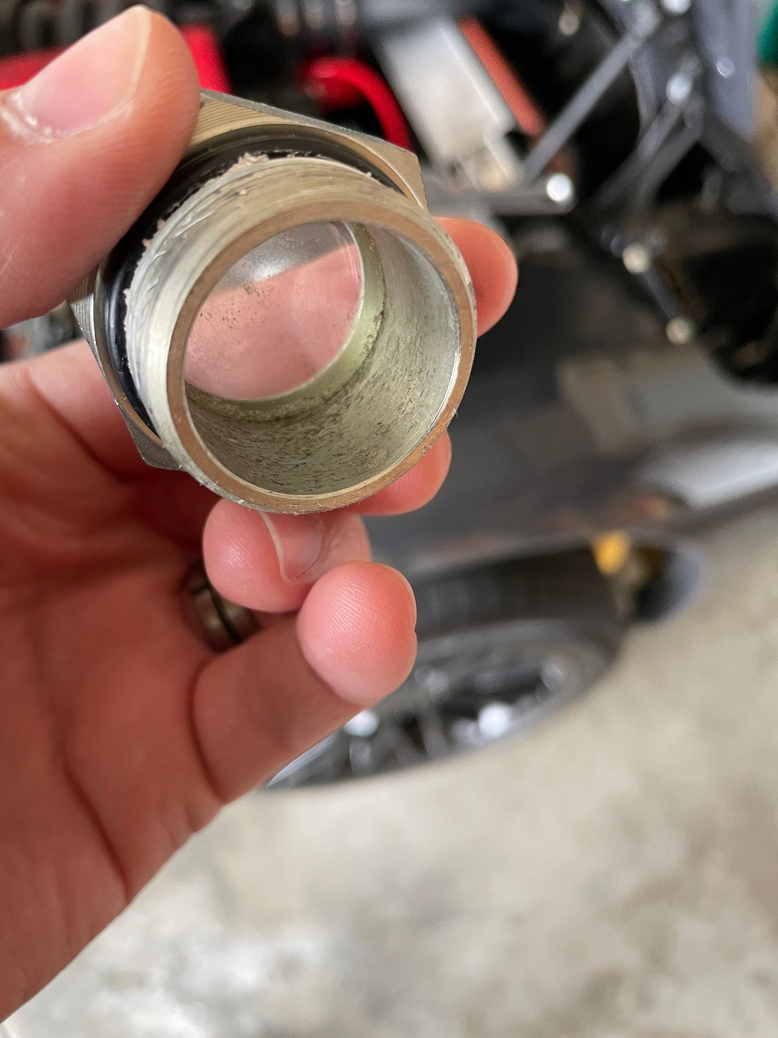

Well, one thing let to another. Found to be getting voltage through my coolant (electrolysis) in a brand new radiator. Proceeded to find evidence of gunk in brand new coolant through sight glass. Isolated the radiator, issue went away. Went to ground the radiator and immediately noticed that the ground on the frame rail was hanging on by a thread. D&T through frame, will be attaching a new stud tomorrow and we’ll see if everything works properly again. Also, very throughly flushed the coolant! While things are apart decided to throw some new DRL’s in

Sand paper will only take it down to bare metal, and just promote more aggressive corrosion. Start with a nylon brush and contact cleaner. Blow it out with compressed air.
A huge no on the dielectric grease. Dielectric grease is an insulator, and will only increase the contact resistance. The connector itself has a seal to prevent water ingress.

Contact cleaner & Scotchbrite seemed to do the trick.
