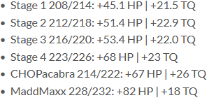

If you think you have traction problems now. Ha! New heads and good cam selection will make even more power. You have a budget of $3k. That will go quick!
I received some great help from members of this forum when I started asking about cams. Read the link and you will see who they are. Here is my journey:
https://www.corvetteforum.com/forums...-coupe-m6.html

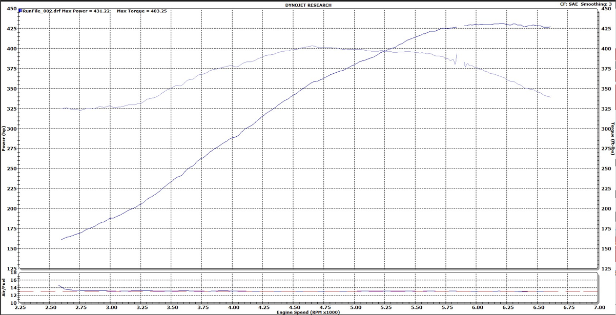

My 98 is a MM6. I went with low lift TSP "Truck" cam. 432 rwhp and 403 ft/lbs was the result. I talked to Issac (Ahbi is also a good egg) at TSP and he said for any of the low lift cams I was looking at with Headers and the CNC ported, stage 1, LS6/243 heads I had... He said go with the Stage IV. I also told him I had no desire for a "Chop", just power and torque at low rpms = Street car. I have nothing but good experiences with the folks at TSP
Looks like Stage IV may work for ya with the 3200 stall? I'd call and ask TSP. They are the experts...
https://www.texas-speed.com/p-9501-t...-camshaft.aspx
I scored the LS6/243 heads with 42k miles on them for $350 from a forum member and sent them to TSP for the $899 Stage 1 treatment.
https://www.texas-speed.com/p-1172-p...-castings.aspx
Here is the selection of "Truck" cams I was looking at:
https://www.texas-speed.com/p-1158-t...l-cam-kit.aspx
Look at the drop down for the cam specs...
Then there is this (5.3 data) from the TSP dyno:
If you cannot score some used LS6/243 heads you can always get the TSP "Brawler" new made in the USA castings, with the same CNC porting and 5 angle valve job, as the Stage 1 service I bought. If you stay with a truck cam you can ask about a, Substitution for LS6 GM beehive or PAC 1218/1218(X) single spring setup. So many options...
There is a **** ton of "While you are there" items when you do this. Get good lifters, I went GM Performance LS7. I read some horror stories about all the major brands and cant help but wonder if some of the reported failures were from counterfeit parts. Then there is the population that wants to run thew biggest cam possible with the cheapest lifters. I also changed every rubber item I touched, belts, hoses, WP, PS hoses...
10k miles since the install of the parts, last year. Runs great. I'm no engine builder, but let me know if I can help. There is a spread sheet with al of the PN's and costs at the end of my build thread. Good Luck and post what you end up with.

I cannot comment on your 220/220 cam with those 225 heads. I have no reason question TSP's guidance. I have nothing but good things to say about my interactions and guidance from TSP that I was given. I just have the stage I CNC ported heads. My heads were procured from a 2003, Z06 with 42k miles on them. They are the 243 casting heads, which also bump the compression a touch to 10.4 to 1. A stock LS1 is 10.1 to 1. If you read thru my build post several forum member here told me to get better heads. That is exactly what I did, The 243/ Z06 casting heads are working great. I sent them to TSP for the stage I CNC porting. I re-used the stock valves from the Z06 heads. Exhaust valves are sodium filled and the intakes are hollow to save weight, had low miles, so I re-used them. The CNC program that TSP uses also comes with a 5 angle valve job. Flow numbers are here:
Really nice numbers from a stock casting with stock valves imo. CNC machines are wonderful and repeatable
The stage IV is the TSP "Truck" cam and is a modest .550 lift in my car. Intake duration at .050 is 223° and exhaust at .050 is 226°. The reason I went with this cam was to be easy on the valve-train parts, plus I wanted torque. There are trade offs with cam design. If I had a cam that liked 7500 rpm shifts, I know myself and I'd be shifting it there, till it blew. This cam is happy at 6000-6500 rpm shifts which is perfect for me. I love to drive this car and have already put 10k miles on it in the last year since the cam/head/header upgrade. There is a little surge below 1500 rpm in gears 1-4 at steady speeds but that may be able to be tuned out. I thought about asking the tuner again, but for now I'm just enjoying the car. Its not unbearable and I just hold it in gear (MM6) a tad longer before up-shifting to avoid that issue.
As far as how a high lift stage IV truck cam would work, I'd defer to the folks at TSP.
You may want to ask TSP about the "Brawler" heads they offer. Sounds like a new 243/Z06 head with big valves and dual springs/Ti retainers. Ask how the brawler compares to the 225 heads...

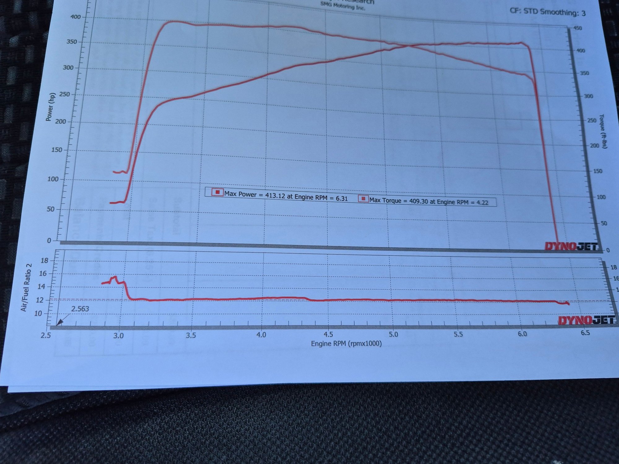

[img alt="Finally!
I had an issue getting it tuned. I chose a tuner that couldnt tune driveability for whatever reason.(228/230 .585/.585/112lsa) Ugg. I took it to SMG in Mendon, Ma and he did a great job! Not bad for a 228 cam through an a4.
Ive already went from 3.15s to 3.42s, but it could stand 3.73s or even 3.90s."]https://cimg8.ibsrv.net/gimg/www.corvetteforum.com-vbulletin/2000x1504/20250701_170349_445679a917aa1236fae49de0 6d74c4486e4ca20d.jpg[/img]
Finally! I had an issue getting it tuned. I chose a tuner that couldnt tune driveability for whatever reason.(228/230 .585/.585/112lsa) Ugg. I took it to SMG in Mendon, Ma and he did a great job! Not bad for a 228 cam through an a4. Ive already went from 3.15s to 3.42s, but it could stand 3.73s or even 3.90s.

Sounds like a fun car. Just curious what your final numbers were? Stock heads, stock intake? In the end, it doesn’t really matter what the numbers are, as long as you are happy and it rips.
