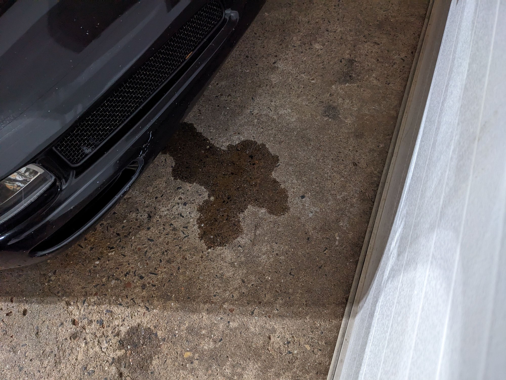

Hi there. My ECP radiator has developed a leak. I still haven't figured out exactly where from as I will need to pull the fan shroud, but the coolant is collecting and dripping from the mount under the drain ****. At first I though it could be the drain **** and replaced that, but that hasn't stopped or slowed the leak with a new replacement. I do know it's not coming from any hose or fitting as all is bone dry after many inspections when hot or cold. Seems like it's either coming from a pinhole in one of the welds or a fin.
I did not personally install the radiator, it came installed when I purchased the car, but I know it was installed in '21-'22 because it was the last mod performed by the previous owner, so there is likely no warranty.
In case it's not an obvious/easy fix and I need to go with another radiator, should I roll the dice on another ECP radiator? What's everyone's experience with them? Doing a search in this forum shows mixed experiences. I plan on doing a good bit of HPDE over the next few years, so I won't go back to a stock style rad, but a LG/DeWitts/Ron Davis radiator is out of my price range. $400-500 delivered is about as much as I'm willing to spend, which happens to be the price range for a new ECP.

I'd pull the radiator out of the car and, so long as it's not destroyed, I would take it to a local shop to see if it can be fixed. You have to pull it out anyway ... so ask around and see who still repairs radiators in your area.
Radiator shops aren't usually too anxious to mess around with radiators that have plastic end tanks, but all metal radiators can usually be fixed. Take the radiator to a grown-up and get a free assessment of whether it can be saved.

So the rad shop told me it's unfixable. The shop told me the materials were kind of cheap and advised me to try a different company's radiator. Looks like I'll be springing for something better.
