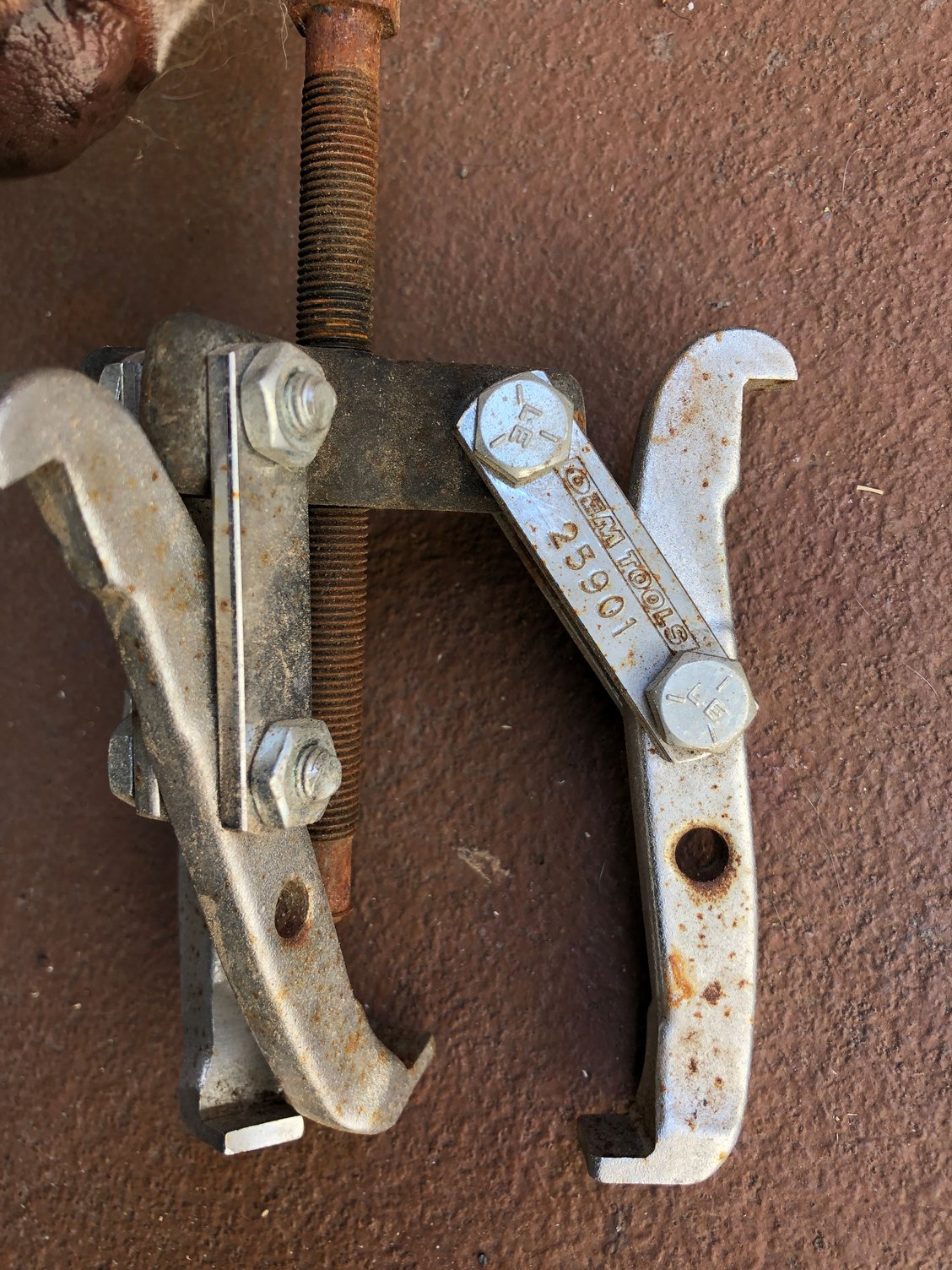

This is my smaller one (part of my dog's nose for scale.) I had to change the wheel on an early 60s tractor that spent most of its life outside. The main puller bolt is deformed on the end and this one would not dislodge the steering wheel. My bigger one that did work is apparently still packed in a box somewhere since my move from Leander a couple years ago.

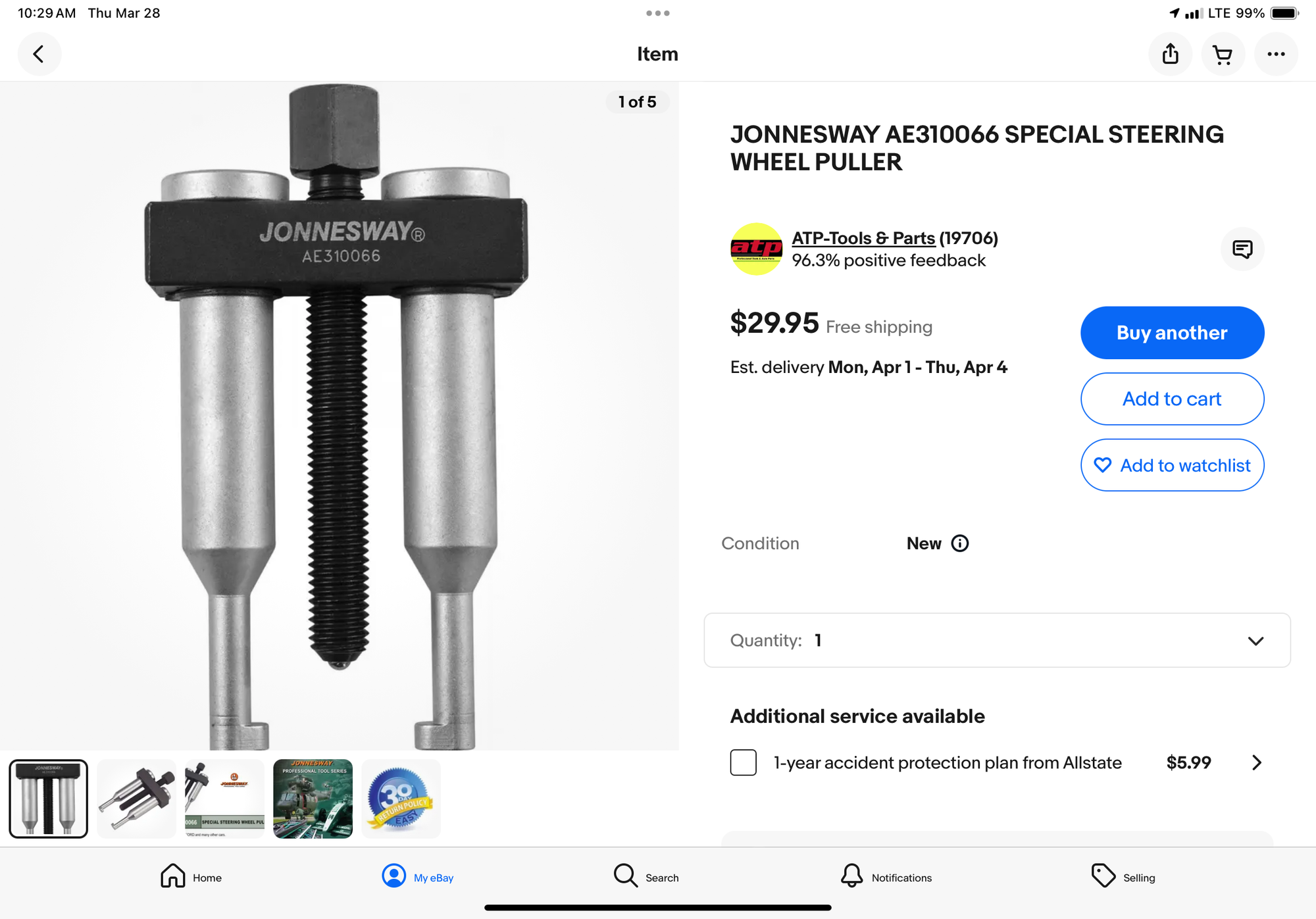

I bought this one off eBay and it worked great. I think it is a knock-off of the one GM recommends

LOL..My dog is the same, always wants to be involved.. I've been living in Leander for ~15 yrs. G'town for 10+ years before that. From the videos I've seen, the 3-jaw pullers seem to be a PITA to use on the C5 wheel due to a plastic piece behind the wheel where the jaws need to go. You have any issue with that?
That Jonesaway puller looks more like what I had in mind. Thx for that reference.

Got a new horn membrane and the Jonesaway puller on order JIC.

Used the Jonesaway puller this week. It worked but was a bit tight getting the legs into the steering wheel holes. If the distance between the 2 legs was 0.030" thousandths wider, it would have been a lot easier to install. After forcing both legs into the slots, they need to be rotated 90 degs. This is where I had the most difficulty. Attached a small pair of vise grips to each leg to rotate them to engage. Wasn't easy since the legs were binding due to being pulled away from each other and limited room for the vise grips. I could have ground/filed the steering wheel slots but didn't want the mess. May do that next time I have the wheel off.
May be that the distance between slots varies slightly from batch to batch of steering wheels but this was my experience with a 2000 coupe.

I did notice it was just a bit tight getting into the slots. I didn’t have any issue rotating them into position on my wheel though.
Glad it worked for you too!

I'm just happy it worked and nothing broke. I've seen many tales of broken steering wheels using a puller. In retrospect, probably should have added a drop of oil to each arm where it rotates.

The last time I had the steering wheel off, I touched the slots with a high-speed grinder. Puller arms fit fine now. I did notice the arms dug into the backside of the steering wheel a significant amount. Not sure how many more pulls are left in it.
