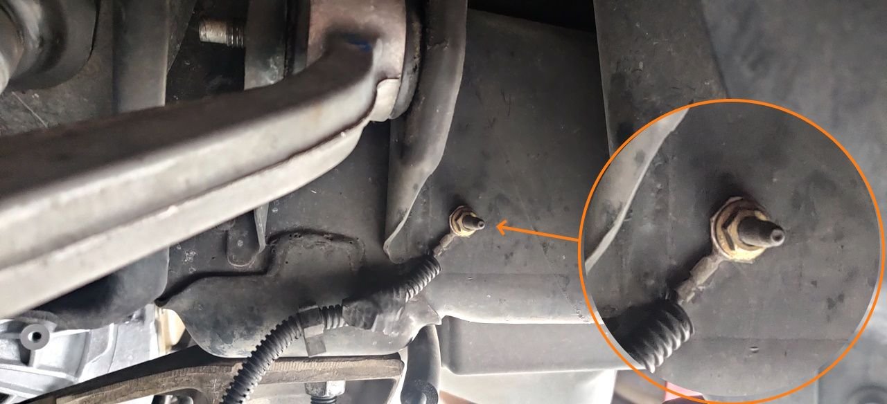

I had a fuel pump that was not priming on my 03 C5Z, turned out to be the ground point on the frame by the driver side rear wheel.
More details: https://www.z06vette.no/2023/11/fuel...g-running.html
