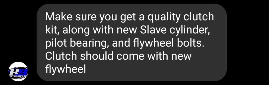

I was told to get all of these things as well. Does this sound correct?
