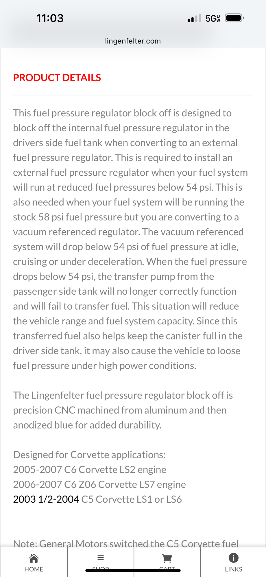

So I think I had two separate problems occurring. The pins on the float arm that contact the level sensor card broke off going over the pot holes which was giving me the sensor code. Secondly the turbo smart vacuum controlled fuel pressure regulator provided with the A&A kit has a return system. I think that the secondary regulator was allowing the fuel pressure to hang below 54 psi at low rpm cruising. I believe it was running through the return line instead of pumping to the siphon pump on the passenger side. It seems to be enough of an issue with running a vacuum controlled regulator that racetronix and lingenfelter sell factory regulator block off plugs to deal with this exact issue. I will keep you guys posted if this corrects the issue when they arrive.
