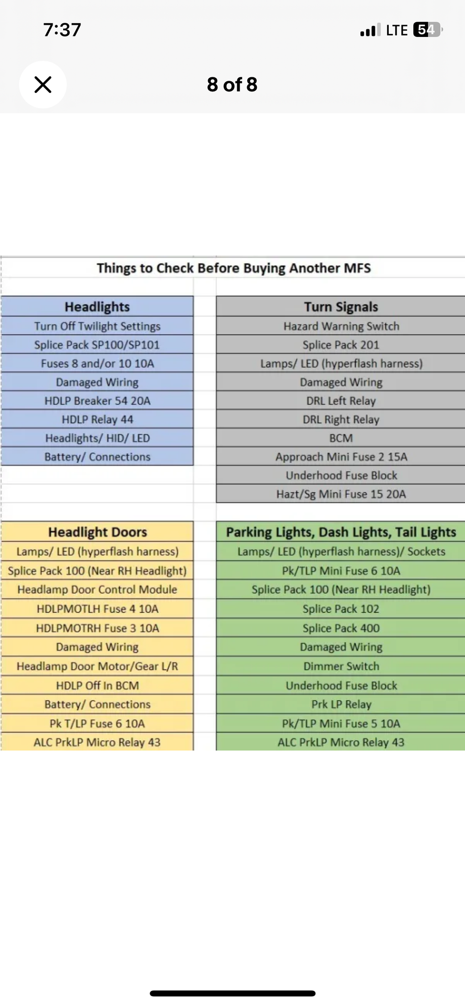

Howdy John! I test, repair, and sell these headlight switches, primarily on eBay. I put this list together to help diagnose but if you are unsure, I am happy to test it for you before you commit to buy anything. First things to check are normally the fuses and splice packs. Easiest way to isolate the switch in the vehicle, if you are comfortable, I’d recommend disconnecting the large connector to the switch and jumping the male terminals W/S to open the doors and W/L to turn on the headlamps. A test jumper wire with alligator clips can be had from Autozone for a few bucks. Please DM me if I can help with anything.

I can't thank you enough for the info it's much appreciated. I will do the headlight/ headlight door harness test when I get back to town. Your flow chart gave me a couple other things to check as well. If it is the switch I will be in contact with you. Thanks again,
