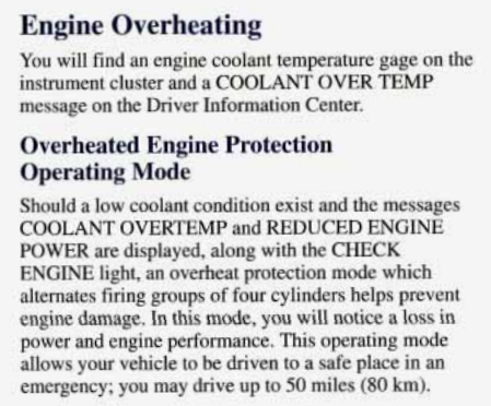

GM disagrees. The owner's manual indicates limping 264,000 feet is within the design intent ..
Remember: The General is in business to sell you parts and services on your vehicle. Short of “escaping the FEBA” (Forward Edge of Battle Area) I would not drive an aluminum-block engine 9 inches with an impending overheating condition.

Originally Posted by FOGeologist
Remember: The General is in business to sell you parts and services on your vehicle. Short of “escaping the FEBA” (Forward Edge of Battle Area) I would not drive an aluminum-block engine 9 inches with an impending overheating area.
I can certainly understand the trepidation for anyone not having a full understanding of the validation testing required to actually put that into print. A lot has changed in 50 years with the advent of electronic fuel injection.
GM has to worry about the liability of telling folks to immediately stop in the middle of traffic. Of course they are not going to advise you to immediately pull over. Instead, they advise you to look for a safe place to pull over. Notice what they do not say in that paragraph. They don't guarantee that there will not be any damage to your engine. They merely say that their limp strategy will help to minimize damage. Of course, due to this advise, they will have great difficulty in refusing a warranty repair, but what happens after the warranty expires? The answer is that it's no longer GM's problem when you cook your engine.
Aluminum engines DO NOT like to be overheated, period ... regardless of what GM's legal team may print in your owner's manual.
