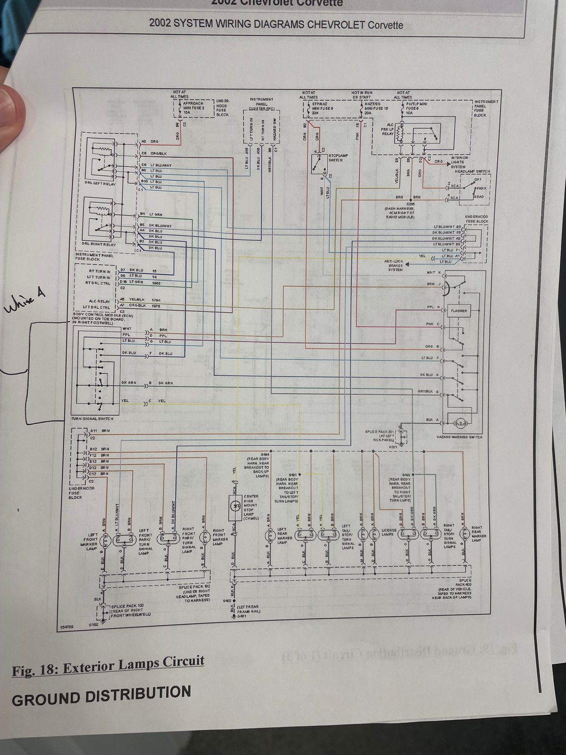

Howdy! I test, repair, and sell MFS on eBay. If only one side is affected, it’s likely not the hazard switch. As stated, it could be a bulb or socket… sometimes the bulbs need to be seated just right in each socket. Beyond that, here is the rats nest schematic; PM me if I might be able to help!

If the bulbs and sockets are ok, I’d guess the MFS… but that’s a rare failure mode for them and they can be pricey. I am happy to test it before you commit to buying anything
