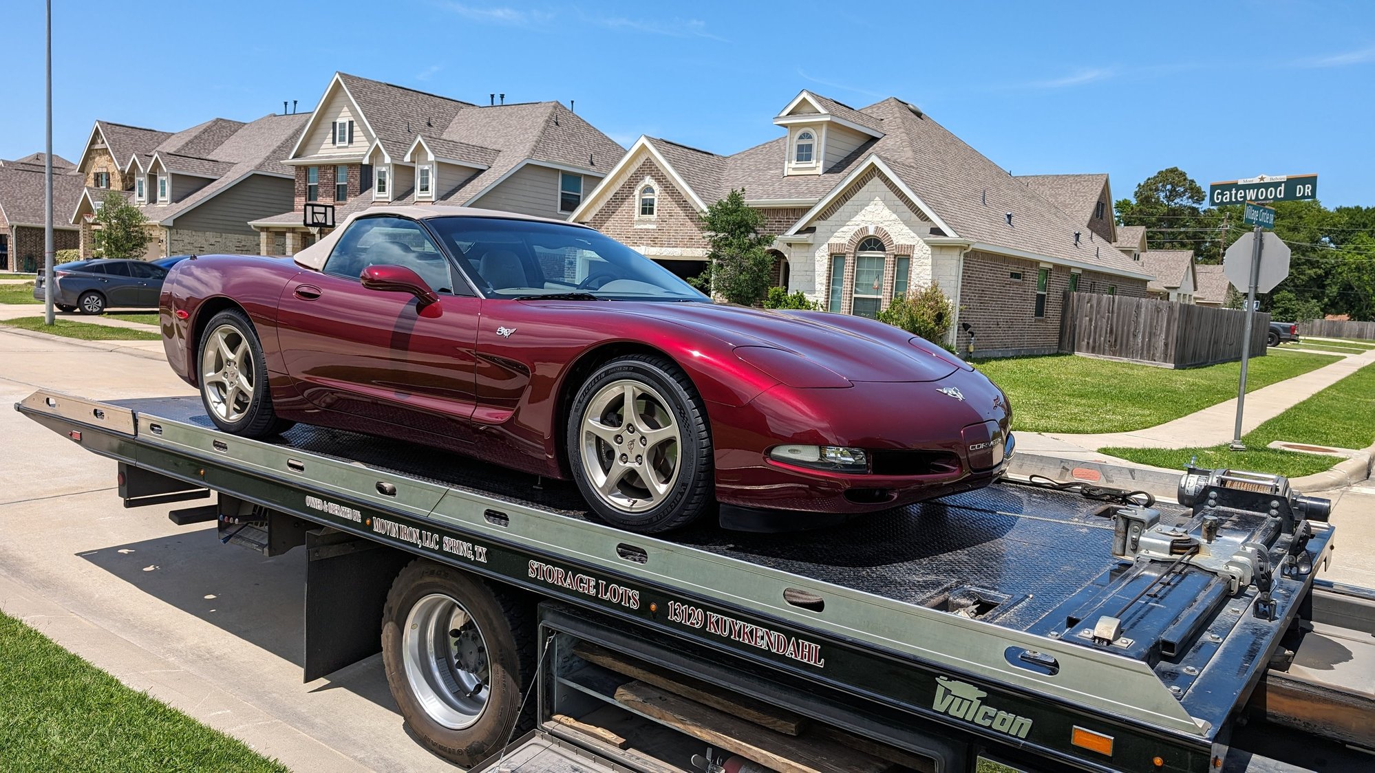

She is headed to Billy Crawford at "Corvette Everything" in Pinehurst, Tx. They received a lot of solid recommendations from many of my Corvette friends. I found the busted back-end bushing on my garage floor just before they towed her away for her spa-day.
She still looks good on a flat-bed.
I think she is secretly excited to get some TLC while at the Vette shop.
Stupid little piece of yellow, brittle quitter.
