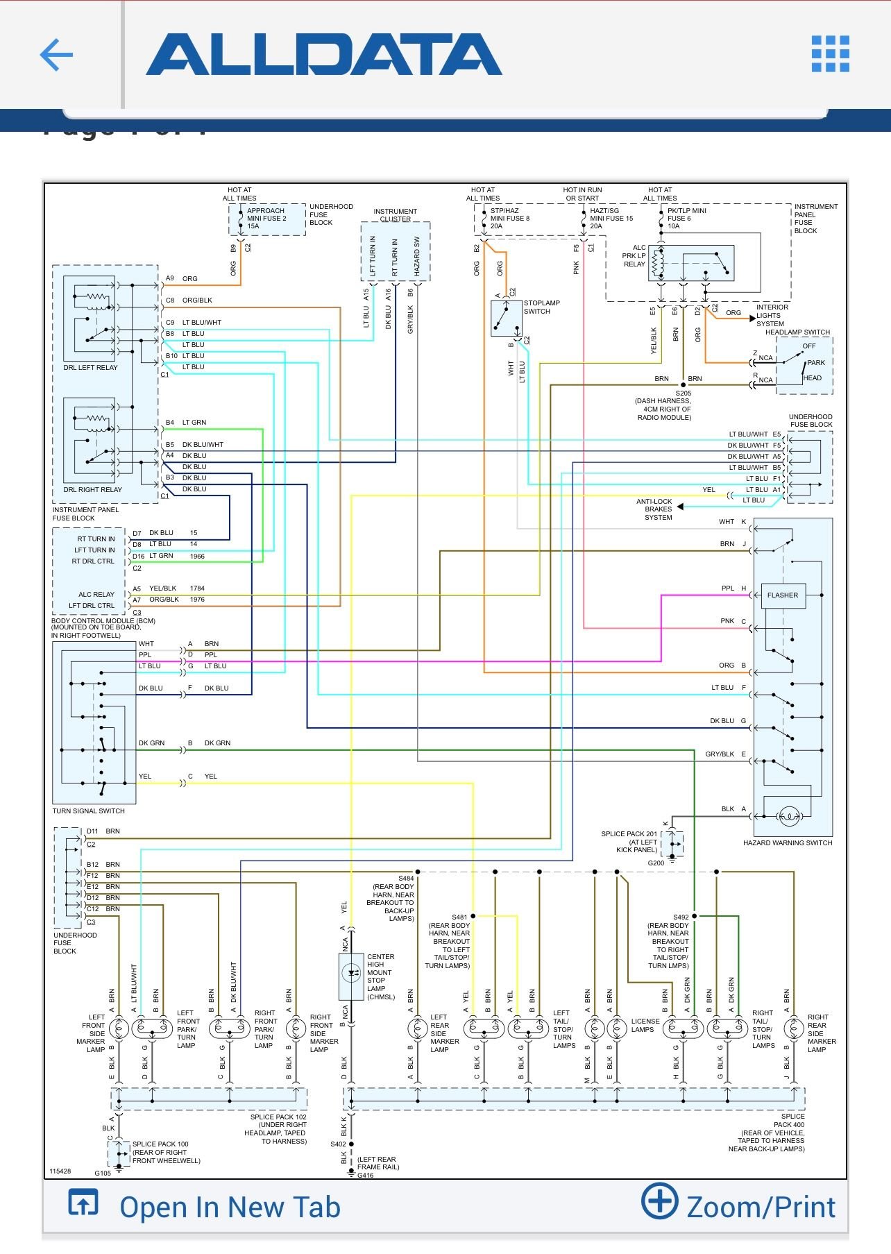

Do you have the wiring diagrams? If not, you can probably find them in the downloadable service manual thread sticky post. I think it's in the C5 General area.
Or I can take pictures of them from my 2000 service manual but they may not apply to your car.

C5 Diag's Avatar
C5 Diag
Moderator, Tech Contributor
Posts: 15,594
Likes: 4,055
From: Cape Coral, Florida
Originally Posted by Bicklebok
I'm not sure I follow you. If the driving light will work, to me the ground is good because the turn signal uses the same ground.
I guess I need to find where the suspect wire's next junction point is and send 12 volts to it to see if the light works. What do you think?
It's amazing what simple things can go wrong with General Motors/Corvettes. I never expected to be troubleshooting a turn signal. I have owned many vehicles and still own too many, and this is the first time I have had to chase down wiring on a turn signal. But when I drive it, its all worth it!
Wiring diagram for a 2001.

Bicklebok's Avatar
Bicklebok
Joined: Dec 2019
Posts: 16
Thank you so much for the help! Hopefully I will get it figured out soon.

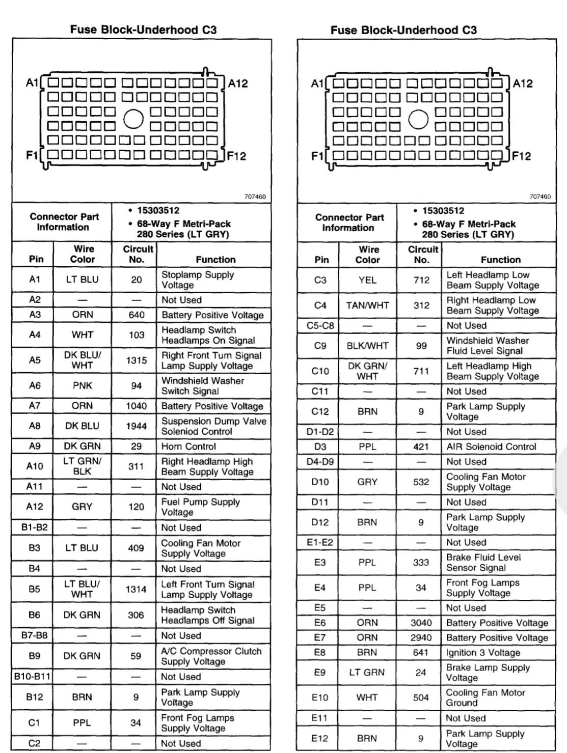

C5 Diag's Avatar
C5 Diag
Posts: 15,594
Likes: 4,055
You will also need this…B5 (Light Blue/White) on Underhood Fuseblock.
