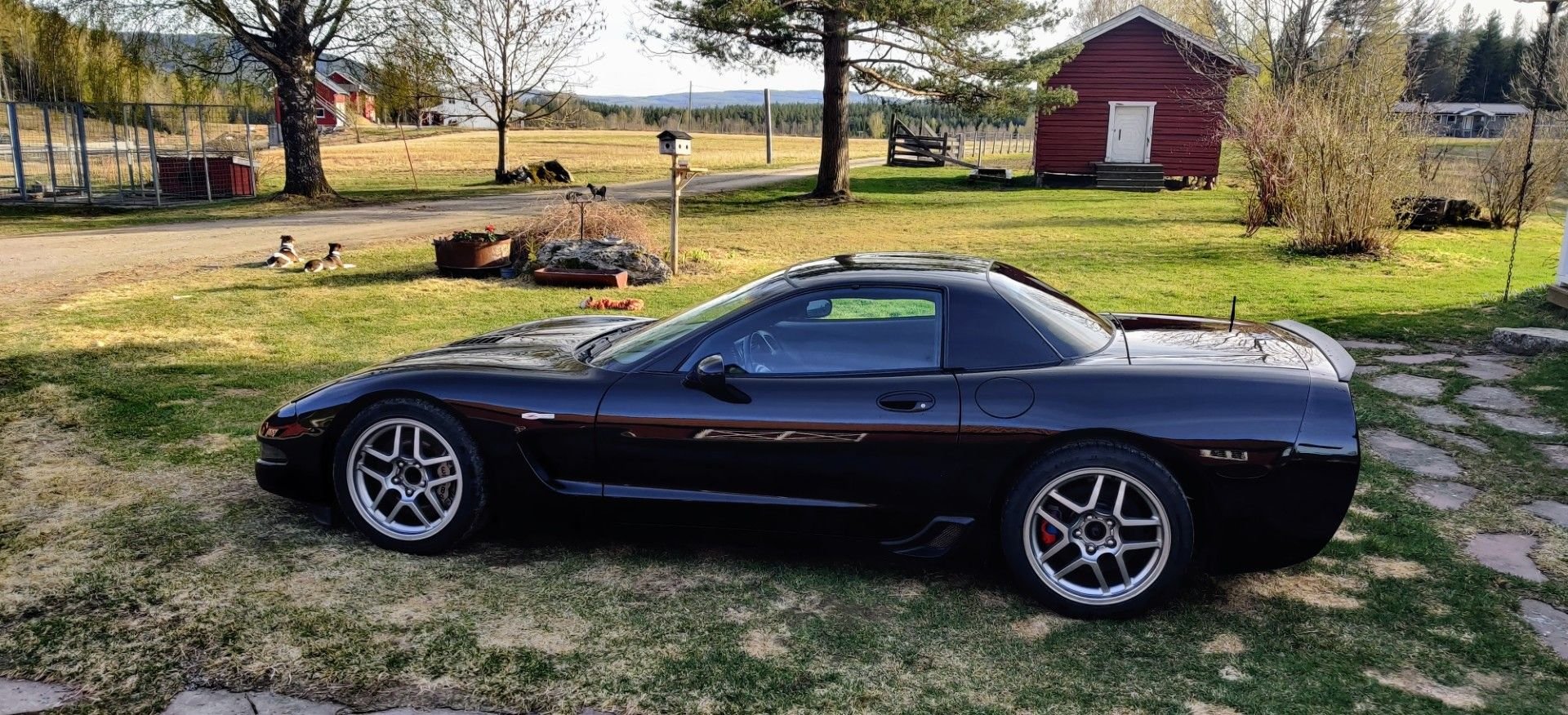

After 1.5 years off the road due to a broken rear differential and performing a complete drivetrain rebuild, my 03 C5Z is finally back on the road again. There's one issue though, the clutch is dragging. Verified by raising the RPM to 5000 rpm in gear with the clutch fully depressed, the car lurches forward 😢 Obviosly, the transmission and synchronizers are not happy - locking out gear shifts. Slave and master is bled using a remote bleeder and clutch pedal is firm. According to my measurements, a slave cylinder shim was not needed. The clutch is a SPEC stage II clutch with a lightened flywheel. Google search tells me that a Tick adjustable master is the only solution? I've put one on order, which became darn expensive ($430 when adding shipping and import taxes to Norway) - so I'm hoping that is money well spent?
