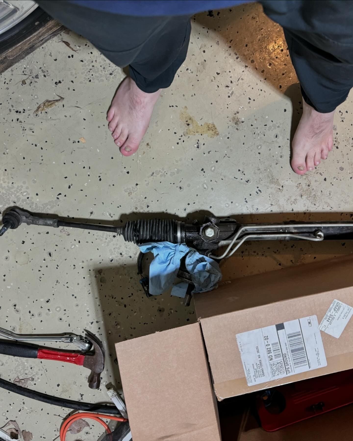

Update, I tried penetrating oil etc the problem was it was on so so tight that with the flare nut wrench the nut was rounding off. So before that happened I ordered a replacement and today after struggling with unseating the PS rack (forgot to take out the 4 ABS bracket bolts), I cut it pushed it across the pax side then pulled it up and out the engine bay. Had to hammer on an 18mm socket and used the impact on it but it’s out and done.
