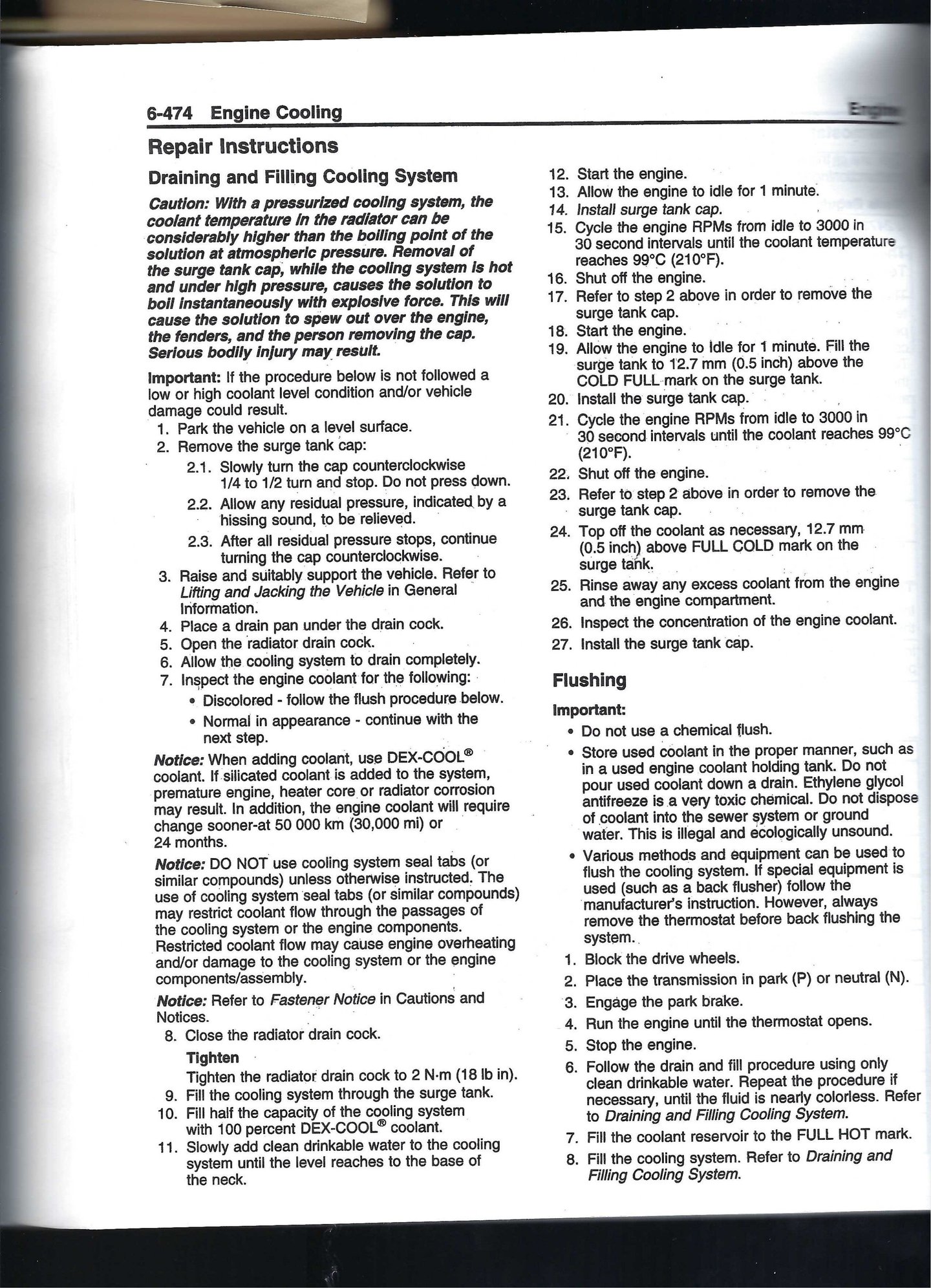

You absolutely have to use the FSM procedure to remove air from the heads. Especially an '04 which does not have rear coolant air bleed piping.

You could have an air pocket in the cooling system, if your temp is always above 200F even cruising.
Everytime I’ve changed out the coolant in my Vette, with the engine cool I’ve filled the coolant to the line, then parked at an angle on a steep driveway or hill with the coolant reservoir tank as the highest point of the cooling system with the car at an angle. Make sure car is pretty cool, coolant temp <100F, Turn on the car with Heater on high with max heat, remove coolant reservoir pressure cap, let it idle, monitor coolant temperature on DIC, once temp hits 200-205F degrees, quickly reinstall coolant reservoir pressure cap. Park Vette on a flat leveled surface, let car/engine fully cool. Monitor coolant level on tank if below line, fill too the line. The coolant in the tank went down because the coolant replaced the air that was trapped in the system.
Doing this process I’ve never had any trapped air or overheating issues, when I was bone stock or to my now current setup (LS3 water pump, 180 tstat, and dewitts radiator with spal fans).

As far as bleeding the system, I was pretty confident it was correct, doing cycling the engine, letting it cool, etc. If i wanted to basically “double check” could I not just open the reservoir cap now and do the same process over?

Yes you could double check by doing the procedure now, if theirs no air in the system and the temps don’t change.

Second, the front coolant steam crossover tube is an ideal spot to bleed air from the system. I would first try the nose high method, mentioned above. If that doesn’t do the job just loosen the passenger side of the crossover a couple threads and let the engine run until fluid streams out.
