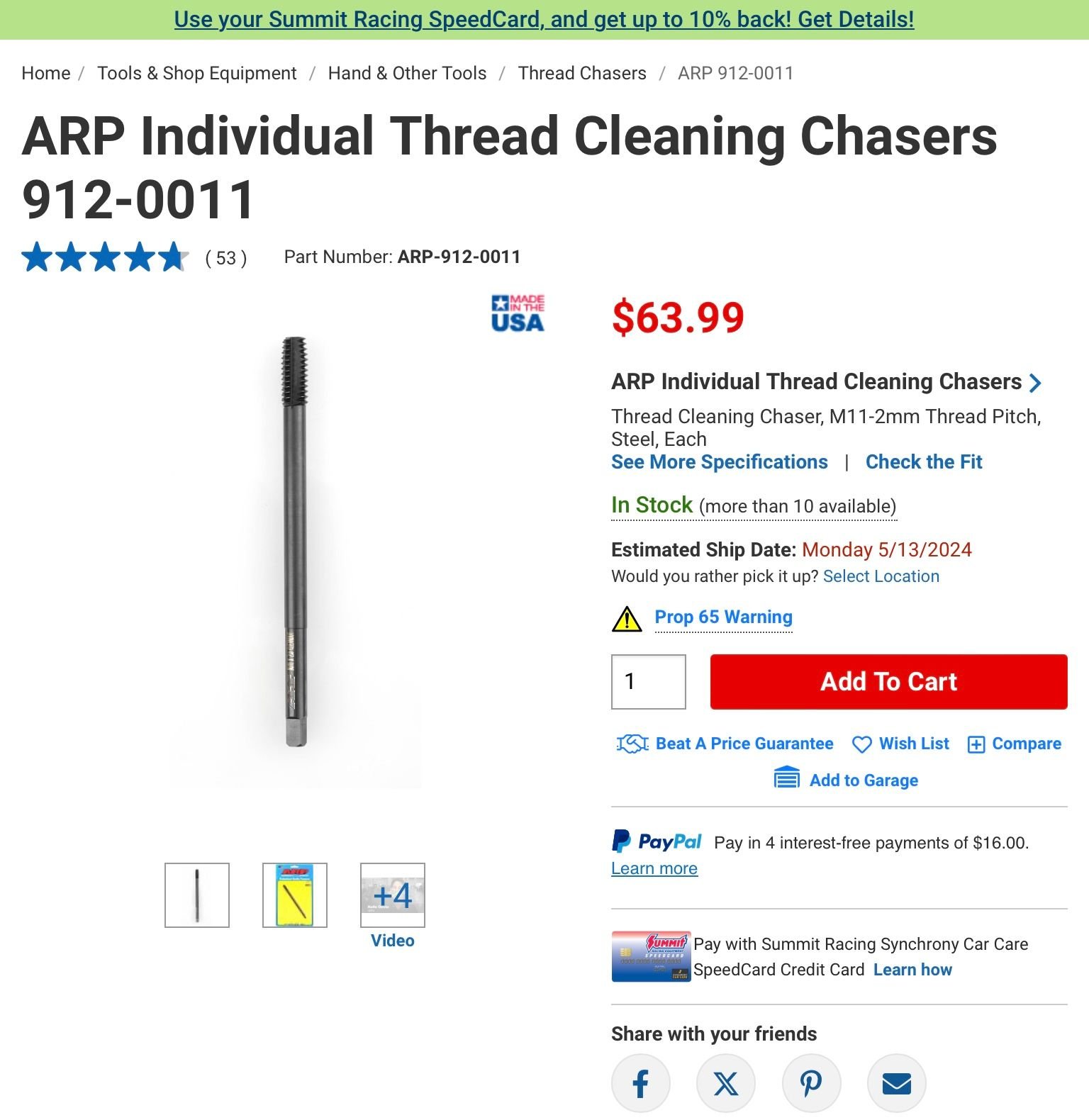

This thread chaser is pricey, but is perfect. Do not use a tap on the threads.
The tap socket below works great with the ARP thread chaser and a battery ratchet (gentle and slow…). Re studs/bolts, studs all the way. A lot easier on your block’s bolt hole threads.
https://www.summitracing.com/parts/ARP-912-0011
IRWIN 3095001B Adjustable Tap Socket, Large https://a.co/d/hf0rwjX
