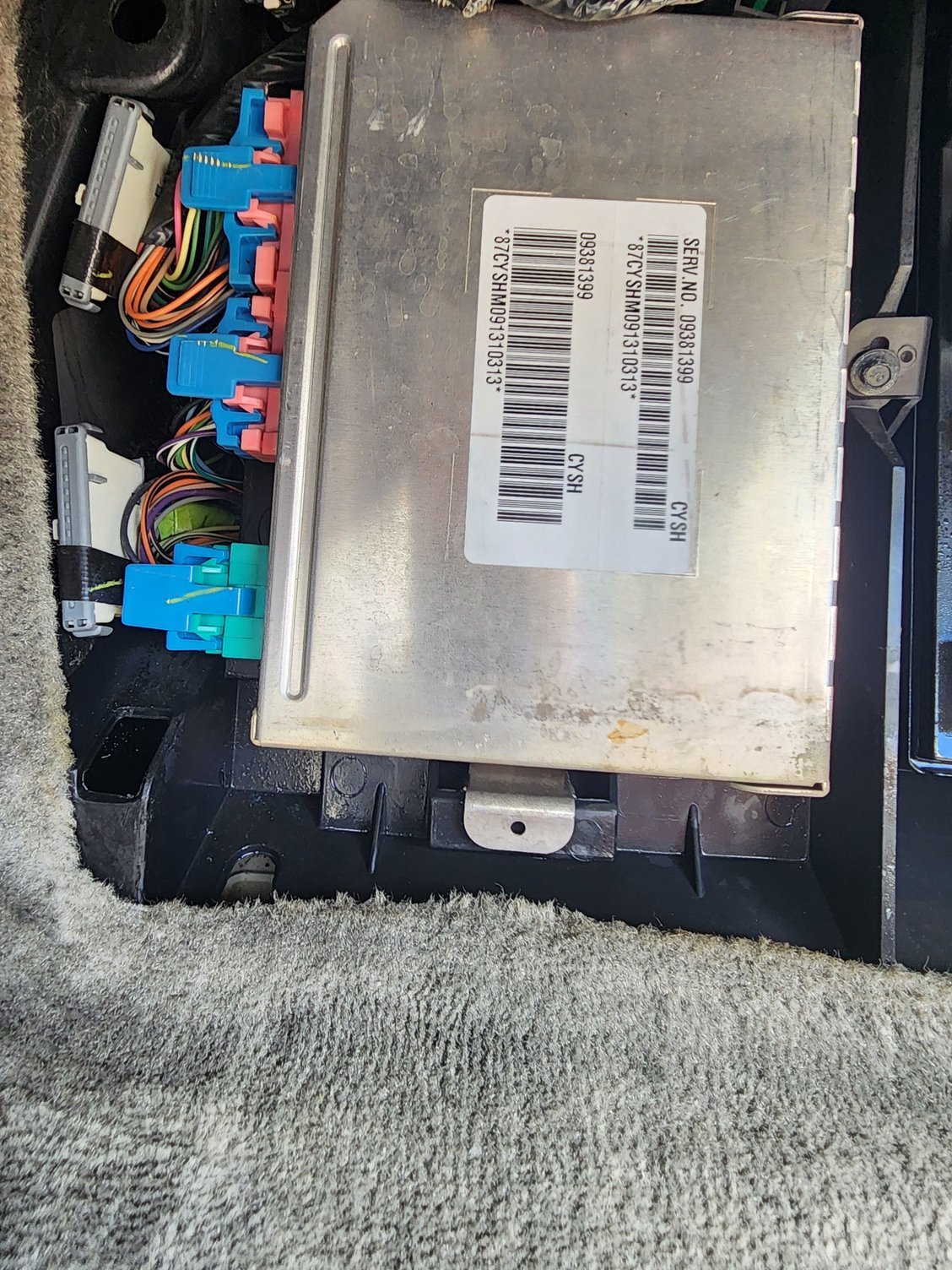

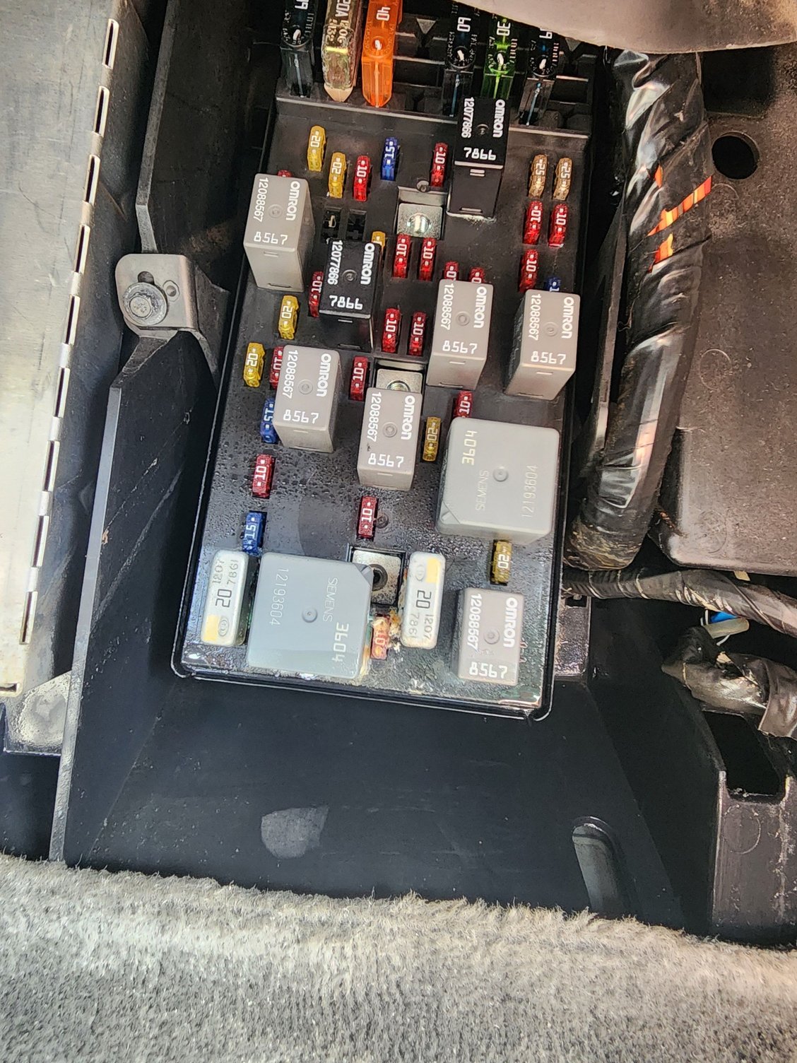

Hey everyone,
Lucky131969 told me to check for moisture and I cant believe I didnt even notice about an inch of standing water under the dash on the passenger side. You can see the water line on the PCM and fuse box. The small fuses did not pop but are soaked. The larger looking things at the bottom look super corroded. The battery completely drained overnight.
Right now the effort is on drying it out to prevent mold and to get all the electronics dry. Im unsure of what to do now, replace the pcm and the fuse box?
Regarding the moisture it didnt seem to come from the roof as all side panels and dash etc are dry, just the passenger side floor?

Originally Posted by PackagedOrca
Hey everyone,
Sorry to hear this. First step, if you have not already, is disconnecting the battery. That is not the PCM, is the BCM ( Body control module). If you are proficient at opening an assembly like this, you can attemp to dry it out/blow out, clean any corrosion, and reassemble. If not, you would be well served to send it out for repair(if replaced it will have to be programmed). Same procedure on the fuse box. Complete disassembly, blown out with compressed air, contacts cleaned where corrosion is present, etc. I will PM you my number if you need to chat.
