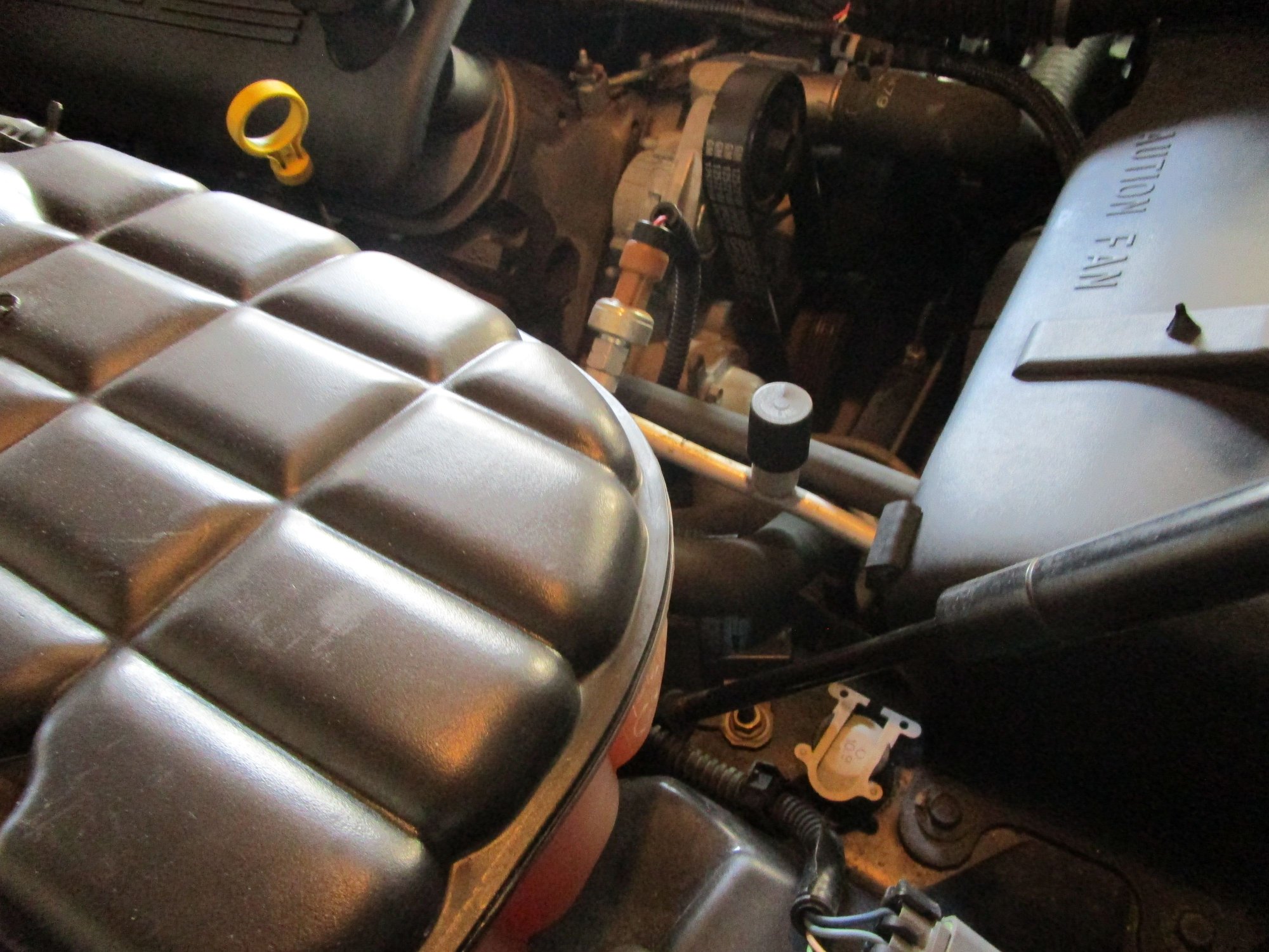

Originally Posted by WildWolf
maybe it's not coolant then ....do we have any green fluid in our cars?
Open the hood and look at your coolant reservoir. Is the stuff in it green? If not, you have ruled out a coolant leak.
If your coolant IS green, look at the coolant level and see how low it is.
Old May 22, 2024 | 10:26 AM
WildWolf's Avatar
WildWolf
Joined: Mar 2000
Posts: 2,347
Likes: 37
From: Dix Hills, NY
Coolant is orange. Must be the dye for the A/C
