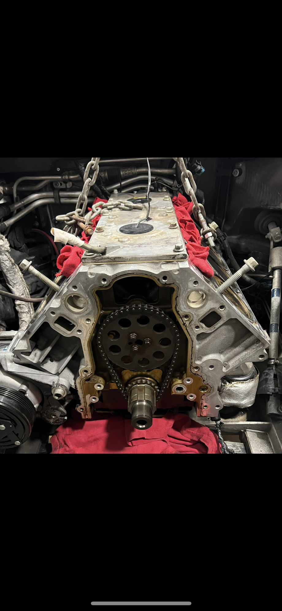

I used two old heads studs, worked out fine.
Did you attach the chains to a gantry, hoist, HF bar or ?
I attached the chain to a hoist. All I was doing was raising the motor high enough to remove the oil pan and to take care of a few other things. I came in with the hoist from the side. Coming from the front got me a little too close to the bumper.
