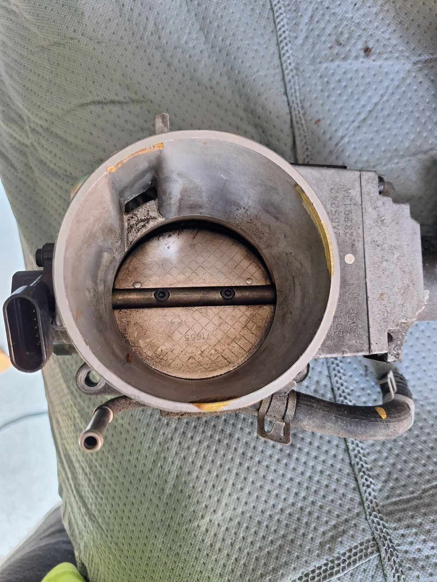

I agree the two cone air intake isn't the best, but it's all I have for now. I removed it, cleaned the filters and lightly oiled them and more importantly cleaned the mass air flow sensor with the proper cleaner. I also removed the throttle body, cleaned it, replaced the rubber gasket and reinstalled it. I haven't tried it out on the road, but it seems to idle better and free rev, so there's that. I'll test it out tomorrow on the road to see how it's doing. I've included before and after shots of the throttle body for comparison.

Will do that in the morning, along with a test drive. I know there was a lot of codes stored in the car, but I didn't write them down, so that is on my agenda, thanks for your comments
