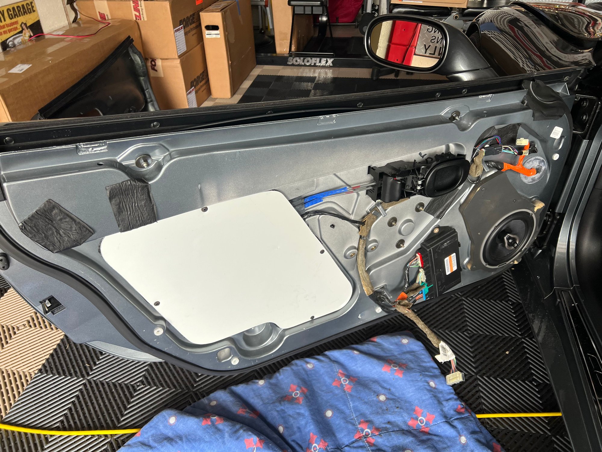

For the past 3-4 years I've been having this problem where rain water will leak into the car through the lower part of the drivers side door. The car was in an accident and I did replace the door with a junk yard one, and that's when this problem started to happen. Not from the top but from the very bottom of the door. I went crazy with trying to fix this recently by replacing the inner door seal, as well as the window seal. I removed the door panel and power washed all the gunk in there to keep the drain holes clean. I even put this black rubber seal so the interior trim might keep the water out. It's like it fills up between the inner door seals and spills over into the interior carpet. This isn't a problem for the passenger side. This is a 2002 Corvette Convertible. Anyone have any suggestions what might be causing this?

Are you sure the water is leaking in through the door panels? Have you checked the udders underneath the windshield cowl in the engine bay to make sure they aren’t full of debris?
You mentioned you did reinstall the plastic rain shield on the door panel that covers the large opening that allows access to the window regulator as that would be the first thing I would check. Mine crumbled when I removed it so I fabricated a piece of fiberglass which I then covered with ensolite sound deadening material and haven’t had any issues.
Another thought is to remove the lower reflector from the door panel and next time it rains reach in to try and figure out where the water is coming from. Maybe even remove the entire inside panel.
I also replaced this. It was crumbling and clogging the drain holes.
I also did this a few weeks ago and at the time it was leaking in from the photo I showed.

As far as I can tell. I did take the 3 utters out and 2 out of 3 were clogged. Not sure if that was the issue.

It rain a lot today and no leaks. I guess it was the 3 utters.
