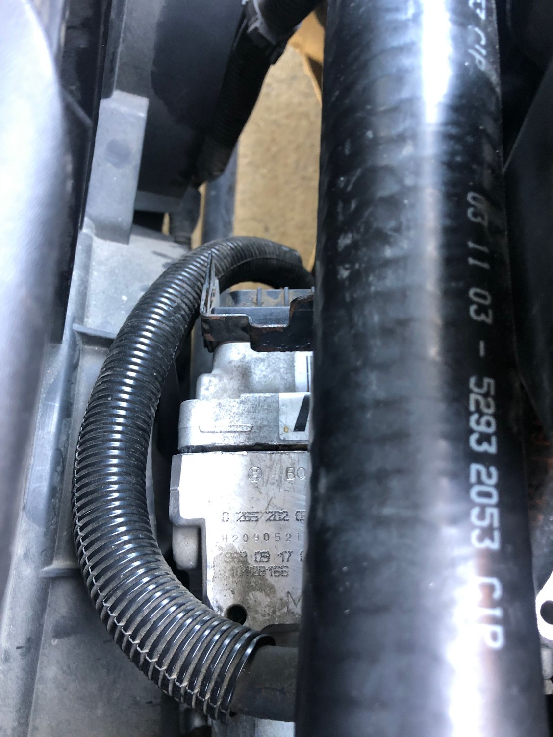

I got the torq screws out and tried prying the top half and got a screwdriver as far down as I could go on the left and tights edges and still doesn’t want to budge without feeling like I’m going to break it the bottom part still needs to be pryed open but can’t get anything down there to get it open any tips/tricks or certain tool I should use?

I don't know about a 2000 but on my 03 If you have all 6 screws out and have cracked the top loose I had to reach in and pull up and out on the bottom of the EBCM.. On mine things were mated so closed it had to be pulled off squarely. It didn't take much to pullit off. p
