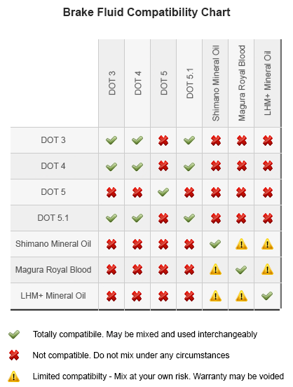

If you are using Dot 5, it is not compatible with your clutches Dot 3 hydraulic system.

First, the type of brake fluid you uses. Our systems require DOT 3, or DOT 4 which is compatible with DOT 3. If you did use DOT 5, they are chemically incompatible and will probably ruin the seals in the master and slave cylinders. Perhaps you meant to write DOT 5.1 which is chemically compatible with our DOT 3 systems.
