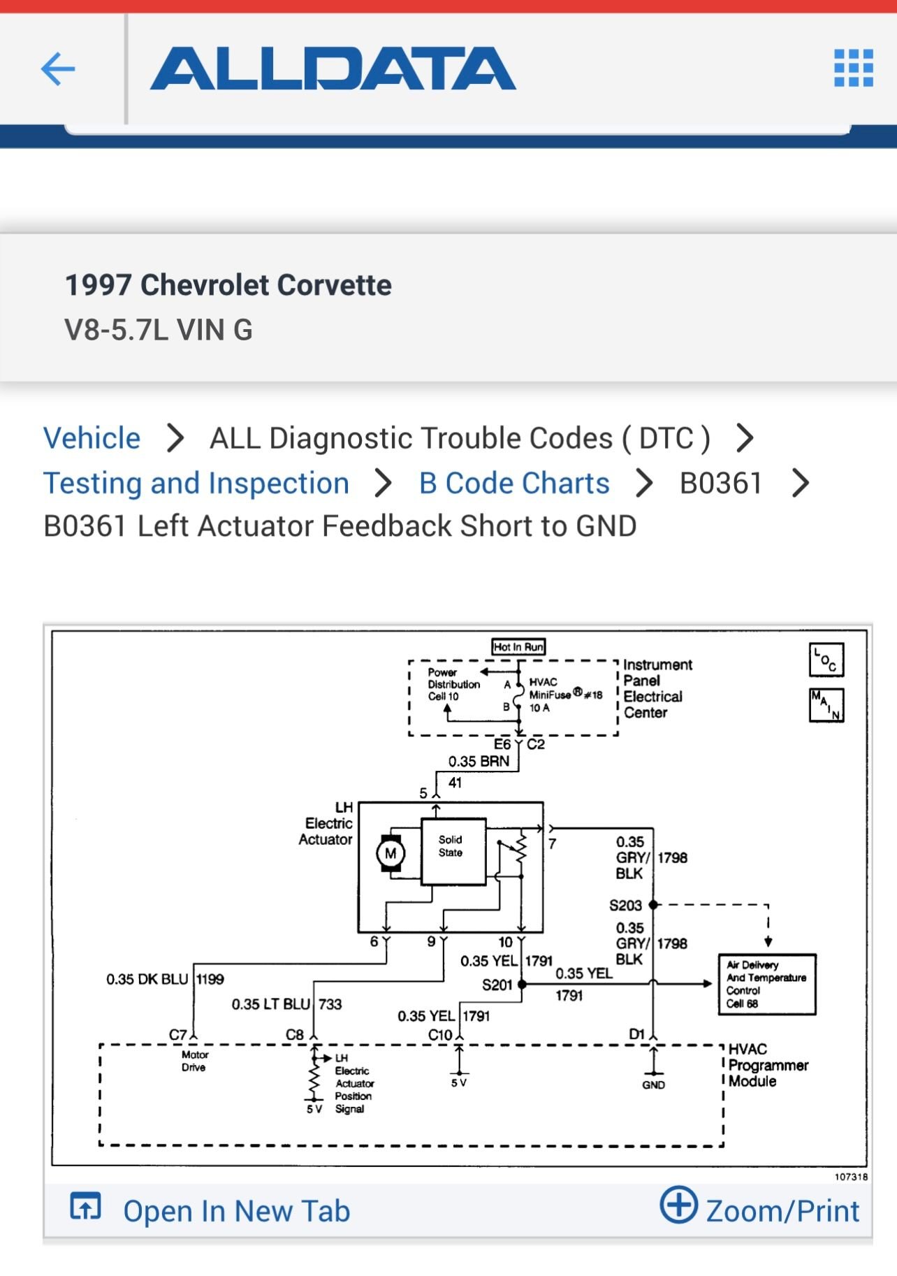

Sounds like your Schrader valve is leaking so the refrigerant is low and as you said you may have a leak somewhere else…the leak needs to get fixed first then add refrigerant…that is why you are experiencing cold on passenger and warm on driver…as far as your other 2 DTC’s the 0361 is a “left actuator feedback short to ground” and the 0441 is “left actuator out of range”…so you have either a wiring issue or a faulty HVAC module or left actuator…so you have a 33% chance if you just want to guess and replace a part…are these 2 DTC’s current or history ??

You’ll need to concentrate on terminals 9 and 10 at the HVAC module…the 2 each 5 volt references.
